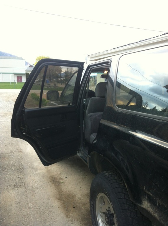

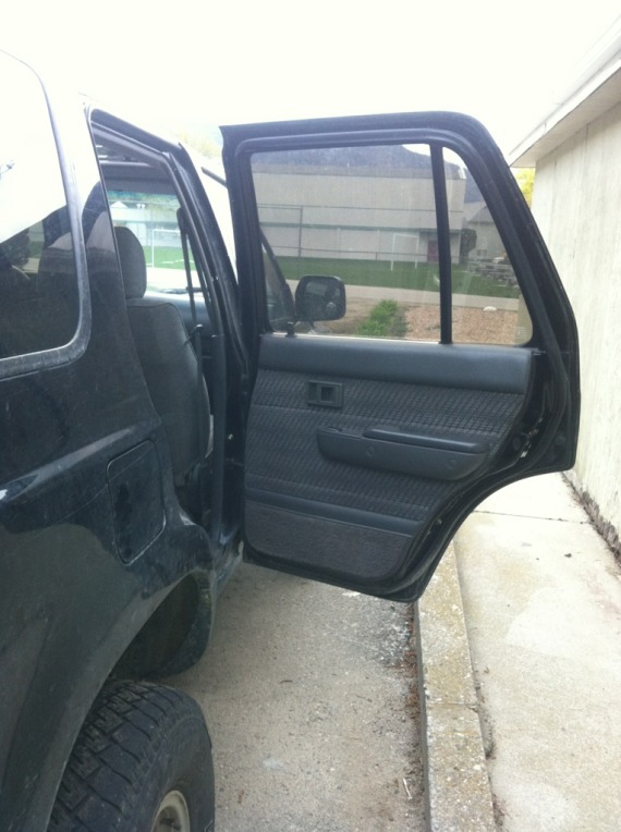

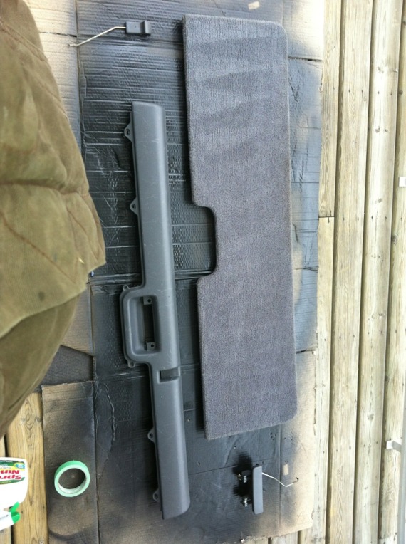

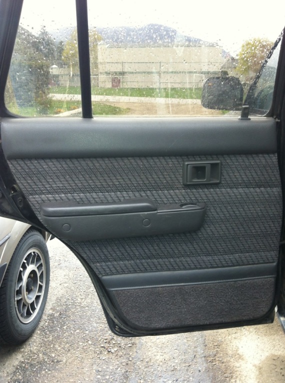

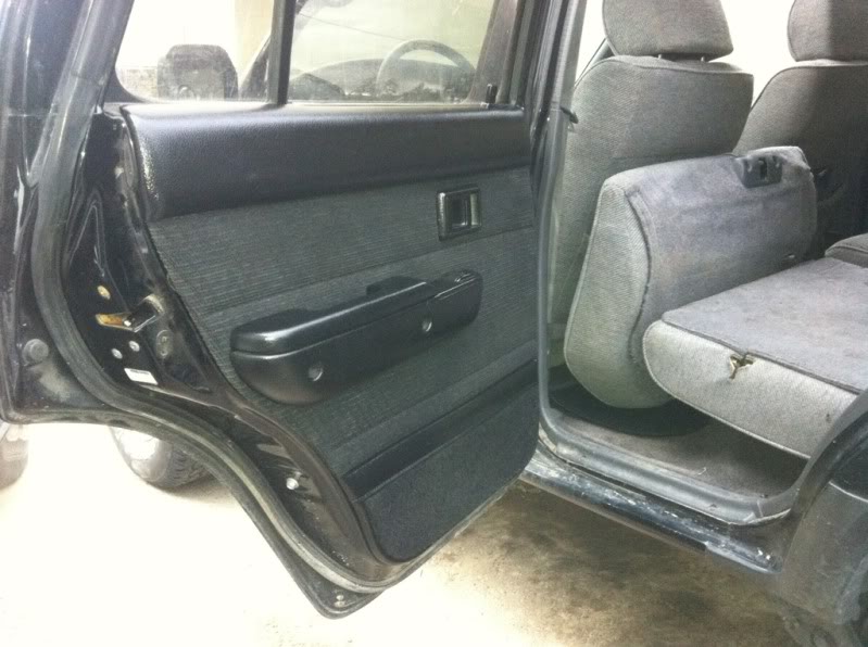

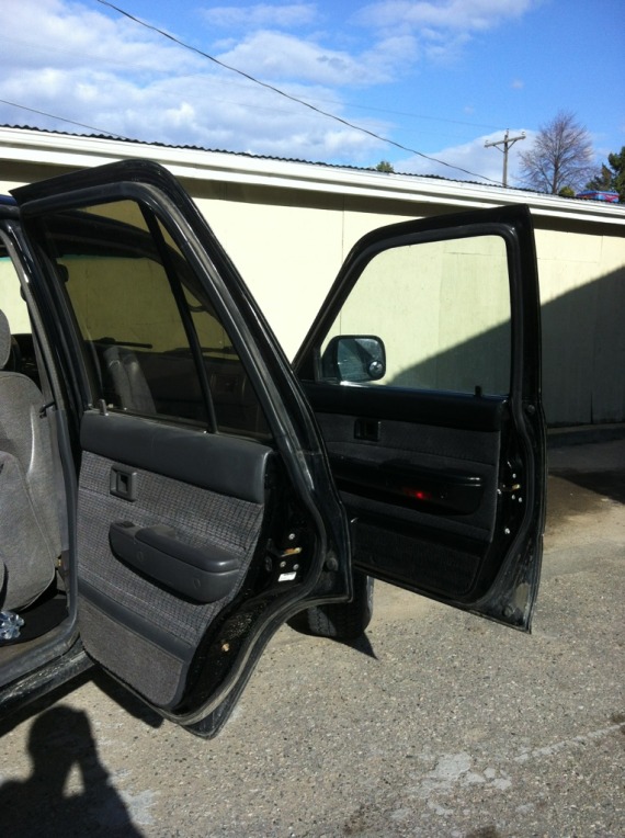

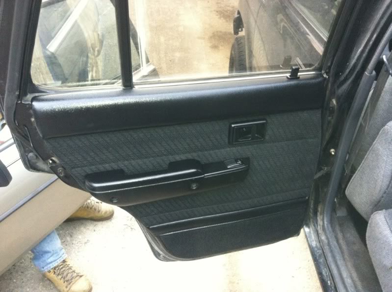

Sorry for no pics last night something came up, but I got the door panel all back together and in the truck tonight and I can't believe how much better it looks, the vinyl part is abit shiny but thats alright. I used plasticote gloss black vinyl/fabric spray and i skipped the boring progress pictures because all i really did was clean everything with spray nine and sharpoo and dried the fabric. I can't wait to do the rest of the truck!

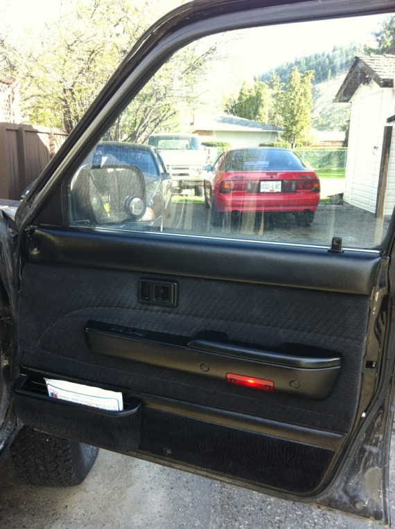

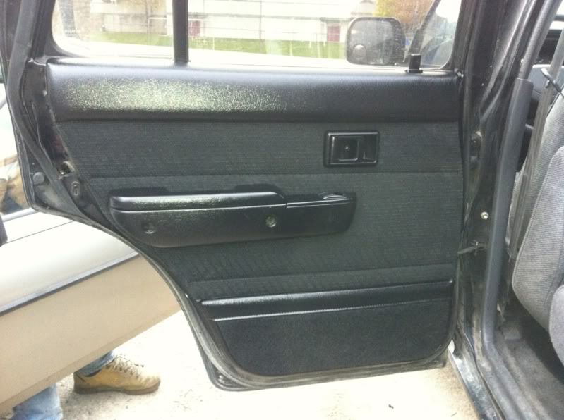

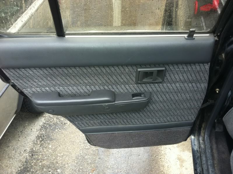

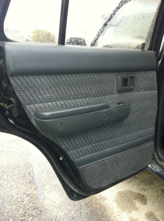

and here is the panel after and installed

Nice touch. My only word of advice would be to make sure you pick a paint that doesn't feel "tacky" to the touch, it'll get messy when the summers get hot. Glossy paints will do this more than flat paints. Looks clean though.
You're right about the black interiors though, I've never seen nor heard of them except for people who do it themselves. I saw a write-up once on how to paint the visors and rear view mirror black and it looked pretty good.

thanks, yea its too bad toyota didn't offer this stock because it looks really good, I hope to one day have the seats wrapped in black leather but thats far away lol. I wold highly recommend very light coats becase it will look horrible with any paint brand if you only do 2 heavy coats. the biggest pain i think will be the dashboard and headliner but it will be well worth it later. I think tomorrow I might do the tail gate so i have scattered black everywhere then ill be forced to do it all haha

Pretty sure your headliner is the fabric type not the vinyl one but thought I'd mention it. I recommend against spraying vinyl if you can avoid it. It takes days to dry and I still wound up having to buff the tack off of my sun visors.

I use the cheap flat black 99 cents at home depot or wally, "Quick color" I think it is. I haven't noticed any difference in the chipping or peeling between the stuff I used primer on compared to the stuff I didn't. I've slipped wih the screw driver afew times on the mirror/light trim it soaked in pretty well.
It's the vinyl bits you have to worry about tackyness. You're upper cloth should take the color just like the door panel cloth did, since it should be the same material.
Probably the most important part of a paint choice is going to be the solvents used. The plastic and vinyl specific stuff you are using will certainly have both MEK and Acetone which ensures it sticks to ABS PP and Nylon. Which covers the three materials used on our interiors, excluding of course leather interiors.
I forgot to mention. Good job sir! They always turn out better than you expect unless you forgot to clean them up first.

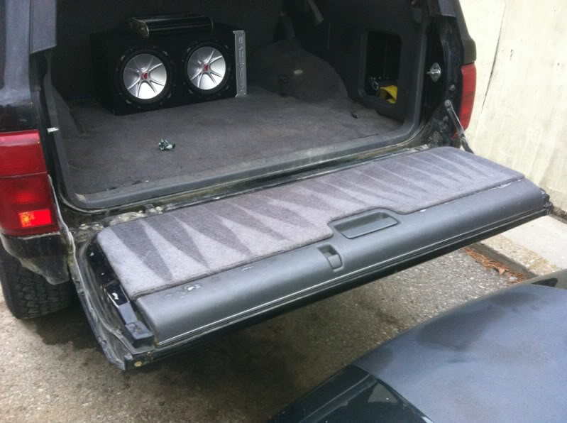

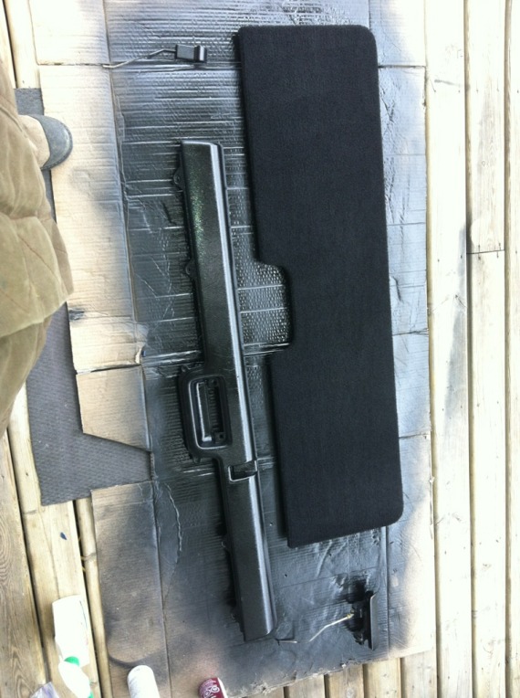

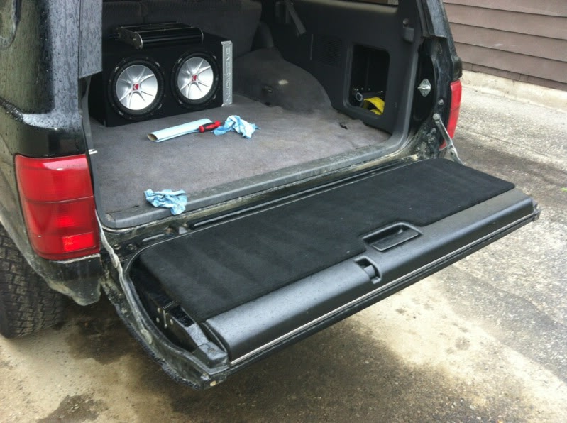

Ok so i got the tail gate finished last night and wanted to post more pics so here they are!

Did you use a carpet dye to get the black on the carpet section of the rear tailgate? If so, what was the name of the product? BTW, it's looking really good. I searched the net yesterday after reading your post, I found carpets and dashes, but nothing regarding door panels or seats other than cheesy seat covers. Must not be much call for the after market or reproduction

Thanks! Yea all i could find was carpets, nothig on headliner or dash or seats, headliner im not sure what ill do about the seats, i MIGHT try and dye them, im thinking i might do the drivers door panel tonight ill take more pics and a pic of the paint can im using
