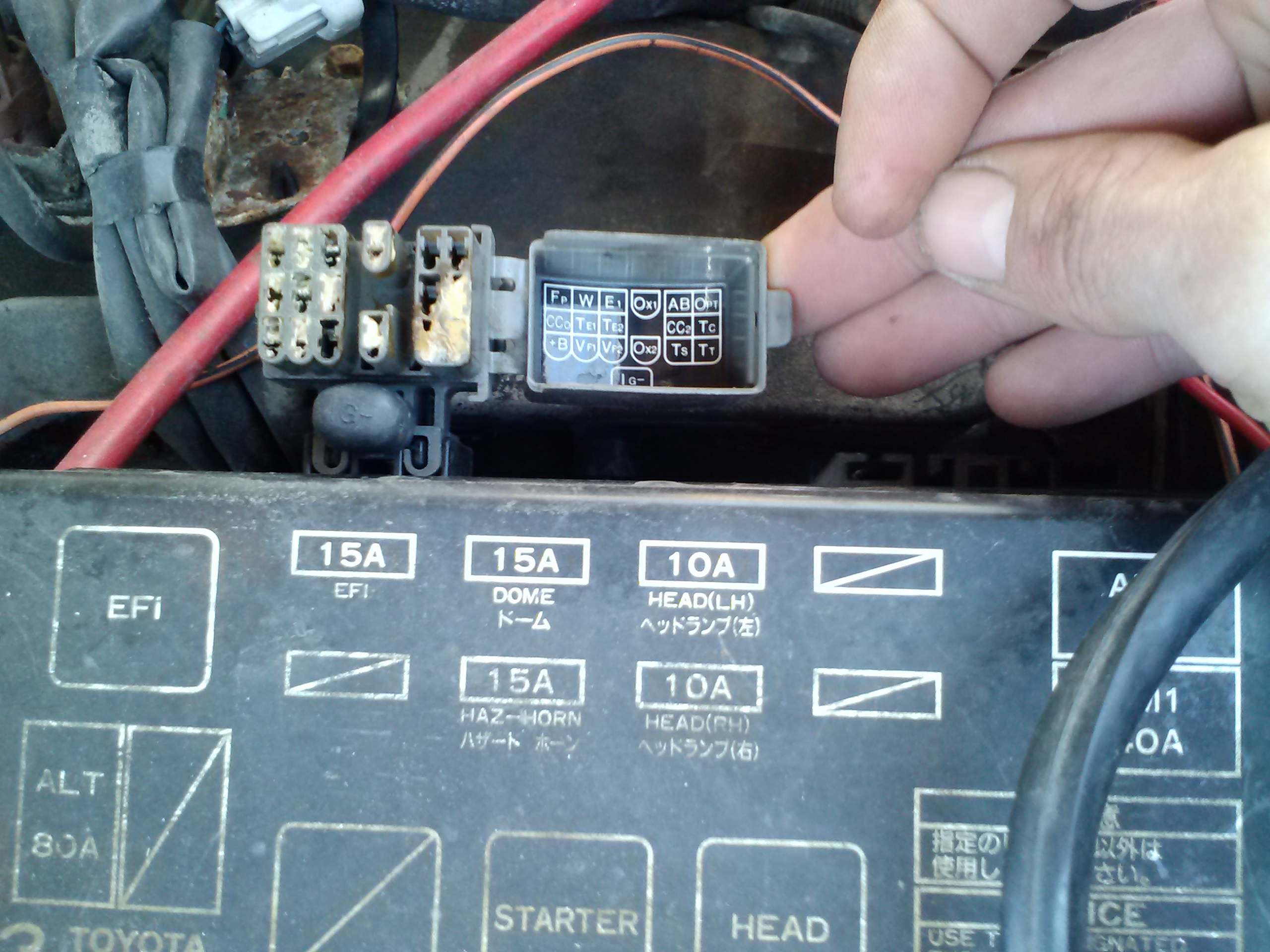

Before you mess with "fuel lines/filters/pumps" jumper FP to B+. With key-on, you should be able to hear the fuel pump running. If not, you have a problem in the COR/VAF circuit.

Yes jumped the B+ and FP heard the pump running.
Managed to get her to run but just barely, continual pumping of the gas pedal. If fuel is getting in there it's minimal.
