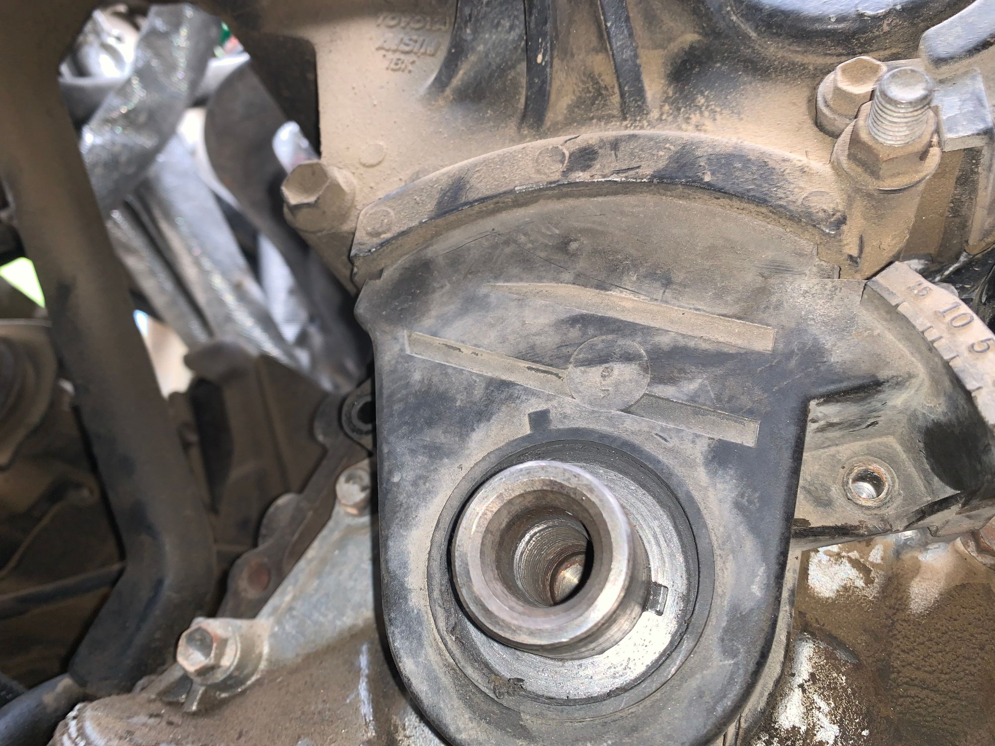

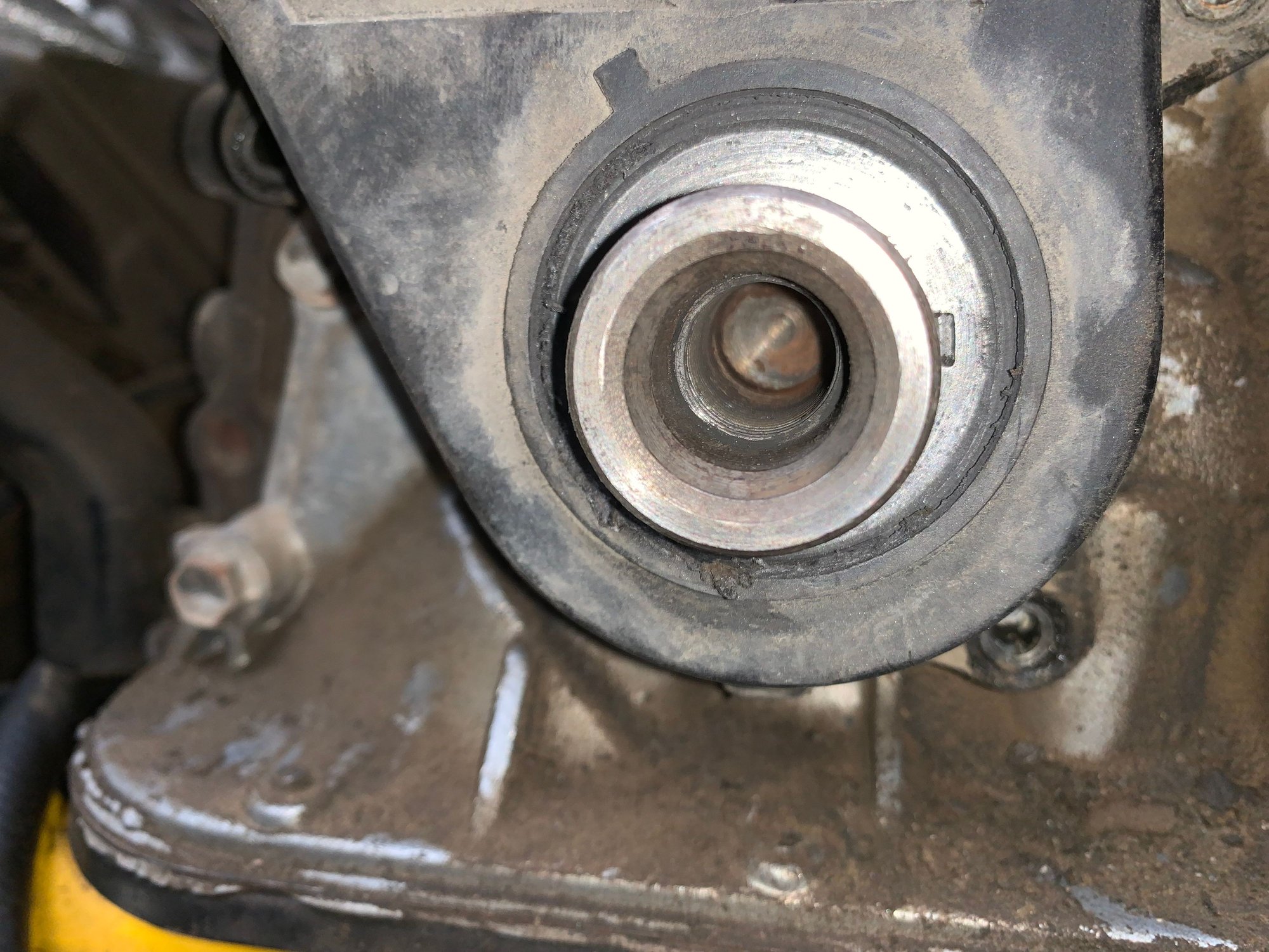

So I opened everything up today. When I pulley the belts off, the crank pulley/balance was able to be wiggled by hand. Was able to loosen the bolt by hand. Pulled it off and the slot for the key was filled with metal powder. Woodruff key looks to have sheard off behind the harmonic balancer and i see no sign of wher the slot for the woodruff key would be. I dont even know where to go from here…

Nevermind, Im just dumb and panic too easily. The crank gear for the timing belt walked out a quarter inch or so since the bolt was so loose. Key is still in tact. I think the powder I saw was ground up plastic from the back of the timing cover.
