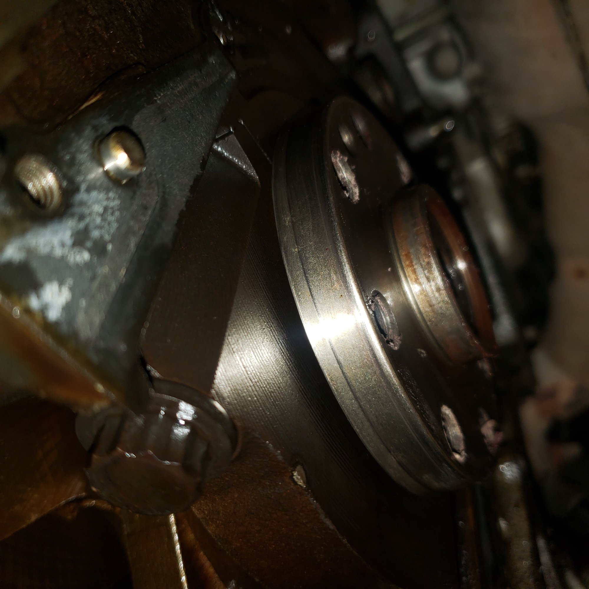

Ok, got it apart today. There was a paper gasket that had basically disappeared from 9 o'clock to 3 o'clock. It was not on the block or the the rear of the plate once disassembled.
Before removing the plate we did notice -- if we looked CLOSELY -- little chunks of gasket material hiding behind the plate near the bottom
Note tiny bit of leftover gasket at upper right hole

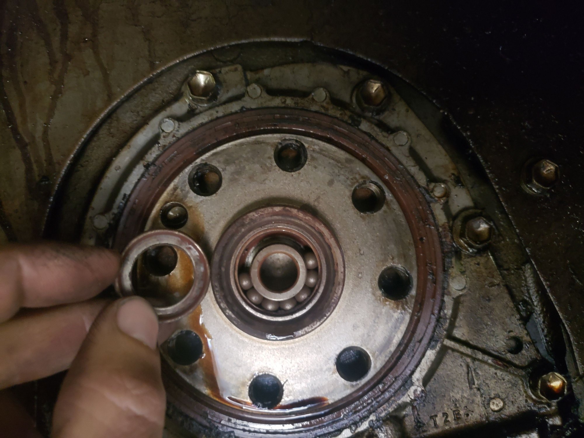

Man, seeing that pilot bearing reminds me of when mine seized up. Ended up having to use a slice of bread and a wooden dowel rod to get it out, because the grease trick wouldn’t work!

When I got in there the first time the pilot bearing was in a sad state. Even after the inner race came out the proper size collet on a blind hole puller was able to remove the small outer sleeve that was left behind. Bread and grease are another great trick to have in the arsenal but I love my blind hole pullers. Every situation is a little different
