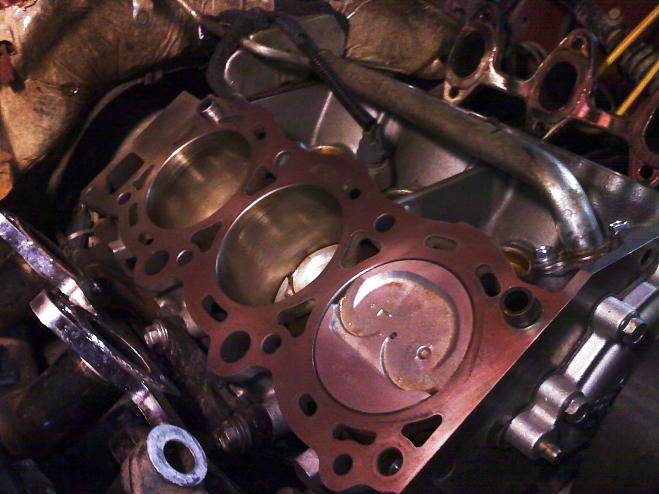

Quick question! On the 3VZE motor. Facing the motor while its in the truck still, should the pistions read L on the bank which is on the same side of the battery? Cause mine do? And the other side has the R on it where the distributor goes. I thought that if you sit in the drivers seat the motor is left and right just like your sitting.
Right???
Wouldnt that mean that my pistons are arse back wards?? Or are the pistons enterchangeable?? I just read on the FSM for the Toyota that the pistons are labled that way cause the shape of the piston varies from one bank to the other.
Help me out guys and gals cause Im about to raise heck on the people who rebuilt my motor. I had the dumb head gaskets go so I am in the process of redoing the head gaskets and saw this.
Every picture of the 3VZE motor that I could find has the pistons the other way around than mine. Is this a major goof up or what???

Pistons should be installed left on drivers side and right on battery side. almost made the same mistake on mine as back in oz we read it from the front of the engine not the drivers seat. your right the pistons are in backwards

3vze
So I was outside in my garage looking at my motor and making sure about what Im seeing is true. In my Haynes manual it clearly has a picture of both pistons and how they are labled L and R. They also say that the dimple on top of the piston should be facing the front which on mine the dimple is facing the front.
The pattern on the piston where the valves come down is different though from the picture in the Haynes manual. Its reversed on mine. Maybe the dimple thru off who ever was putting my motor together. How he didnt see the L and R is beyond me?
I use to think I could hear a knocking when the motor was on if you were standing over it with the hood up. If I reved it, it would go away. I wonder if that noise was the valves hitting the pistons?
So anybody want to see a picture of what Im talking about? I just want to know if Im seeing this right and the motor is built wrong. Help me out folks!

So does anybody know if putting in the pistons this way will cause major damage? I know in the number 3 piston the walls of the block have two HUGE scrapes on the top. Dont know where that came from? Almost looks like that happened before they put the motor together.

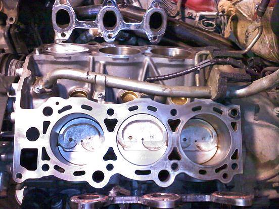

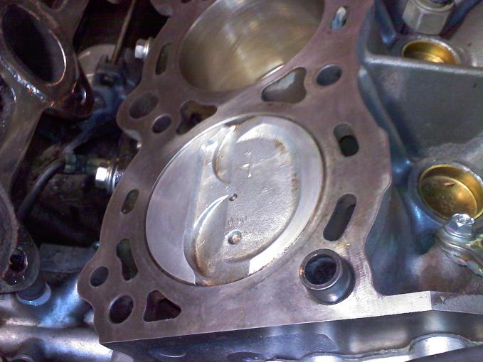

Just want to bump this thread. I really need a difinite answer on this problem of mine. I just need to know for sure that these people who put my motor together did it wrong. The FSM shows the pistons different from mine. Im pretty sure that they are facing the wrong way.
Even the grooves for the valves on the pistons are wrong. Big groove should be for the intake and little groove in the piston is for the exhaust and mine are arse backwards.

there the right way with the dimple at the front but the wrong bank. Thats the problem most people have, They see the dimple and dont look at the lettering. if you move the pistons to the other bank then it will be fine. This is also why you number the rods when you disassemble the block to make sure the pistons go back in the right place. That is of course that when they put the pistons back on the rids they look at the numbers. Usually down with center punch to the bearing caps

as far as the scrapes in the bore it could be a couple of things. Piston pin came loose and damaged it , more likely that a ring broke and caused this damage. I had the same which is why i bored mine out 20 thou over, and yes if they are deep enough you will loose compression. Document everything if you are getting the lawyer involved.

Yes, your pistons are in backwards, essentially. the combustion chamber pocket should be towards the outside of the motor, not towards the centerline of the motor. Damn, that sucks.
In the pic below you an see the bottom end from my motor as it came out of the engine bay. This motor had never been out of the rig since the factory. Your pistons are flipped.
