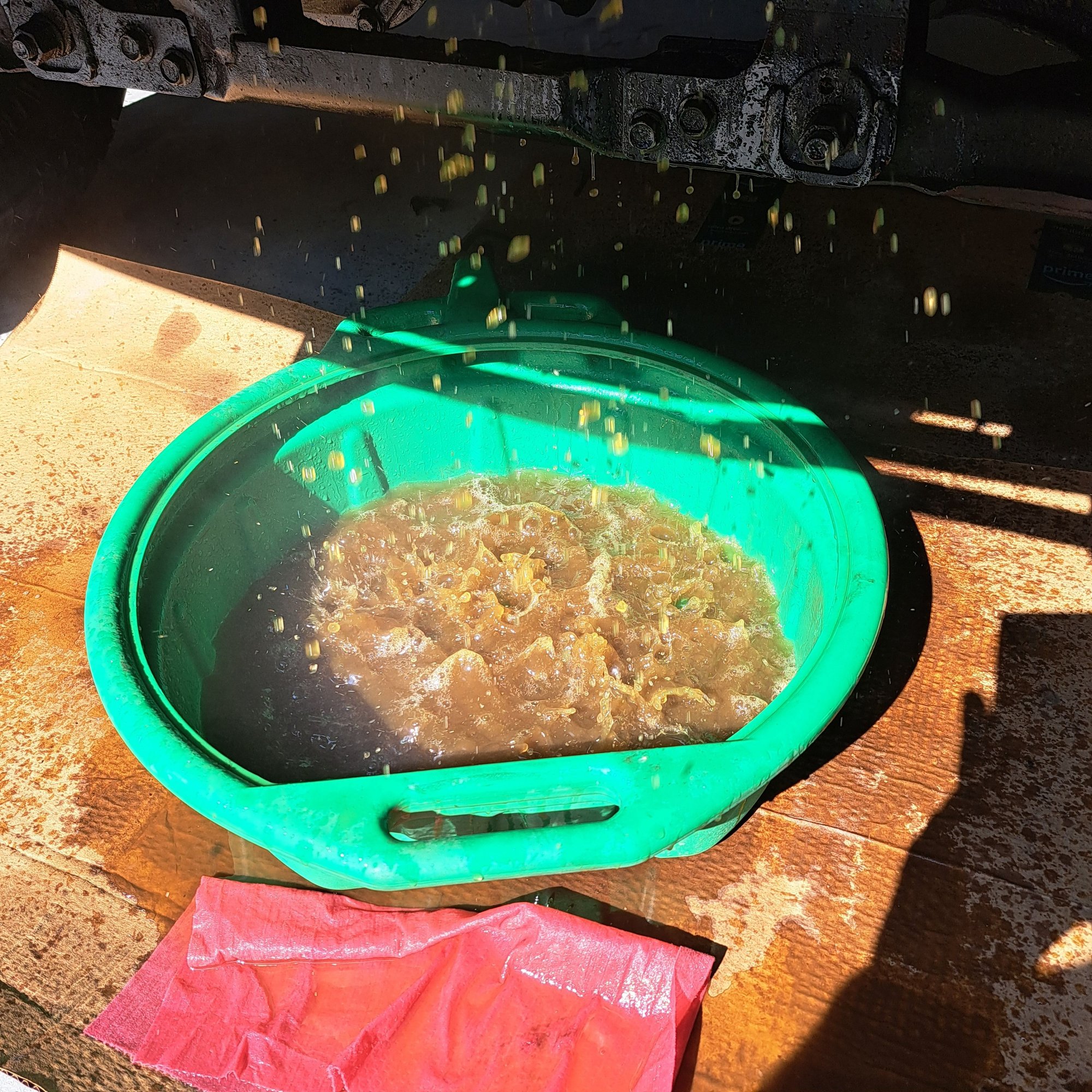

When you flushed the system with chemicals just how bad was the water that came out?

It was gnarly. It was a murky brown but no signs of oil (has fresh 10w40 synthetic in the block). I will attach a picture. Just goes to show flushing it a few times wont get it all. I had to flush my 89 five times before I could get the water clear. Truck rarely breaks 185 deg and thats with a probe in the block not the upper hose.
The brown had a slight reddish tinge to it. The thought crossed my mind that maybe a previous owner mixed coolant colors. Havent seen any evidence otherwise including when i cleaned out the overflow tank.
