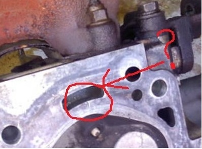

No I don't, But they were posted here so I assume they were correct. But noe I have discovered a new problem, there is a dent/something on the surface of the head. I can feel it with my fingernails when I go over it. It doesn't go all the way to the combustion chamber, But I am afraid it looks like a crack. Any opinions? I will be calling the machine shop monday. Anyone know if I have to remove the exhaust manifolds to get the heads tested?

I finially got this thing running! Yippee. Had the heads tested and re-surfaced. The local machine shop did a great job! Cleaned, resurfaced, and tested for $316 total. Used OEM gaskets for the heads, cheapo ones for the exhaust and intake. I would also like to thank vasinvictor for saving my ass on the cam pulley. The first time around I used the ebay ones, which are built upside down compared to the OEM (Metal against the head instead of against the block. Third time is a charm, I put about 60 miles on it yesterday and she is running like a dream. No overheating, no codes. I think the original problem was my incorrect torquing of the left head, and me no taking enough care cleaning the head mating surfaces. Here are some pics and a video.
