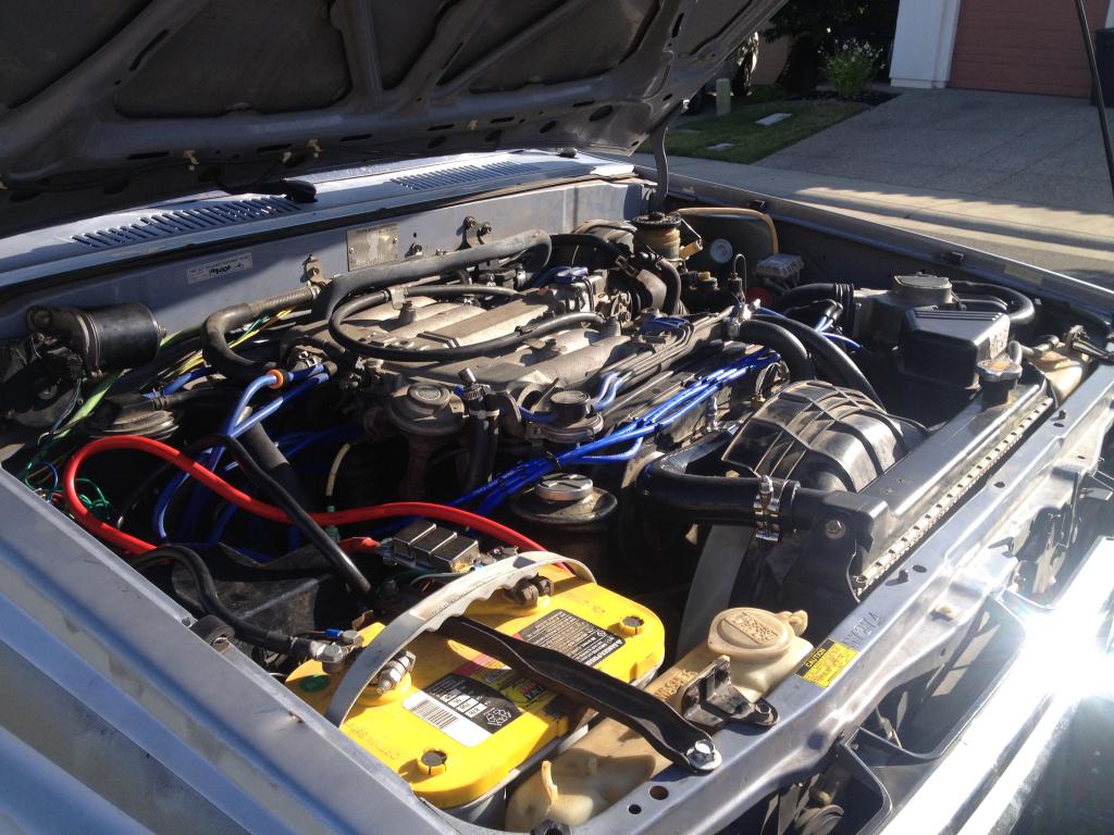

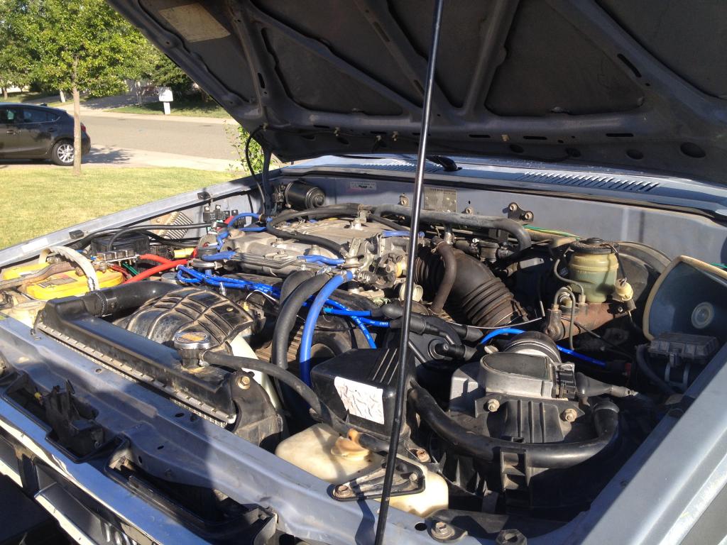

Here's some pictures. Its all nice and blue under there. lol But yeah, has a slight miss... I might have it checked out. the top end has a warranty on it for a year.
