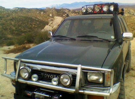

my 4runner on my last 4x4 trip befor the burnt valve
