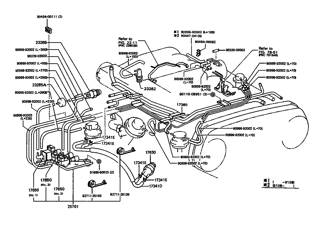

Ok with looking around on here, i have found a few pictures of vacuum line routes. I noticed that there were a few of the lines mixed up. So i fixed them according to the pictures. Now I did find two hoses that were not connected to anything.
Here a picture of what i found to help me out but where is the number 17630 located? Its pictured right below the egr valve. Those two hoses that arent hooked up go to that (as far as i can tell).

17630 goes to the power steering pump. It idles up the engine when you turn the steering so the drain doesn't drop your idle down too far (completely unnecessary; I removed mine when it failed--plus they cost like $200 from the dealer!). You can safely block those off if necessary.

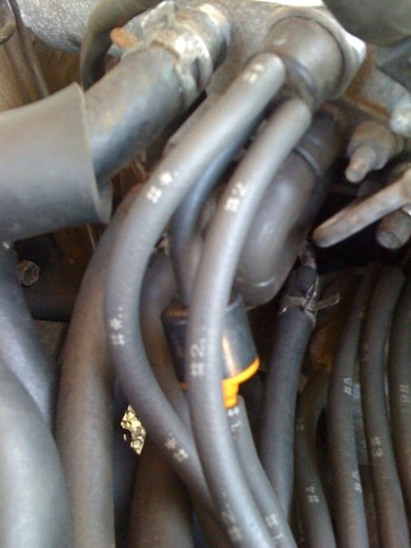

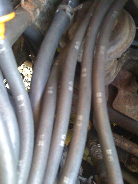

Here is what ive got right now.
#1 and #4 goes to the blue plug
#5 and #2 goes to the brown plug
#6 and #3 goes to the green plug
#* goes to a blue circle filter mounted on the passenger side engine bay
Here are some pictures of where these are going.
In the first picture the hoses are reading #1 to the left with the orange thing, top #*, and to the right #2
In the second picture the hoses are reading #4,#5,#3,#6
Are these correct??
Are these correct??

Even if they are correct, that doesn't mean each component is working correctly. There is no way around it, you need to check each component as indicated and you need to check each vacuum line to make sure they are free flowing.
I could be wrong, but I remember that only disconnecting the big vacuum lines or applying vacuum to the EGR make the motor stall.
