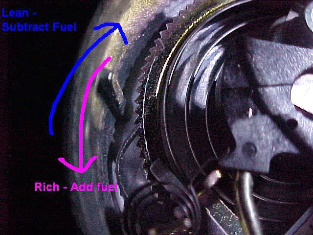

This is a pic i found from one of the write ups

I think that might have been the one I did actually, mixed up the orientation of the teeth in my head.
This one here
http://www.customtacos.com/forum/showthread.php?t=56229

..ok so it is counter clockwise then? How many clicks would be a saFe number?

haha, yeah it depends on how you count... I used that pic above when doing mine, 2 clicks lean. Some people do 3 or more. It probably depends on a few things in terms of safe, as that is fairly relative. 2 or 3 is probably safe, adjust idle and see how the next few tanks work.
Also put a mark at the stock location for reference.
should be moving the teeth clockwise right? probably use 2 flat heads or something to do it, that's what I did
