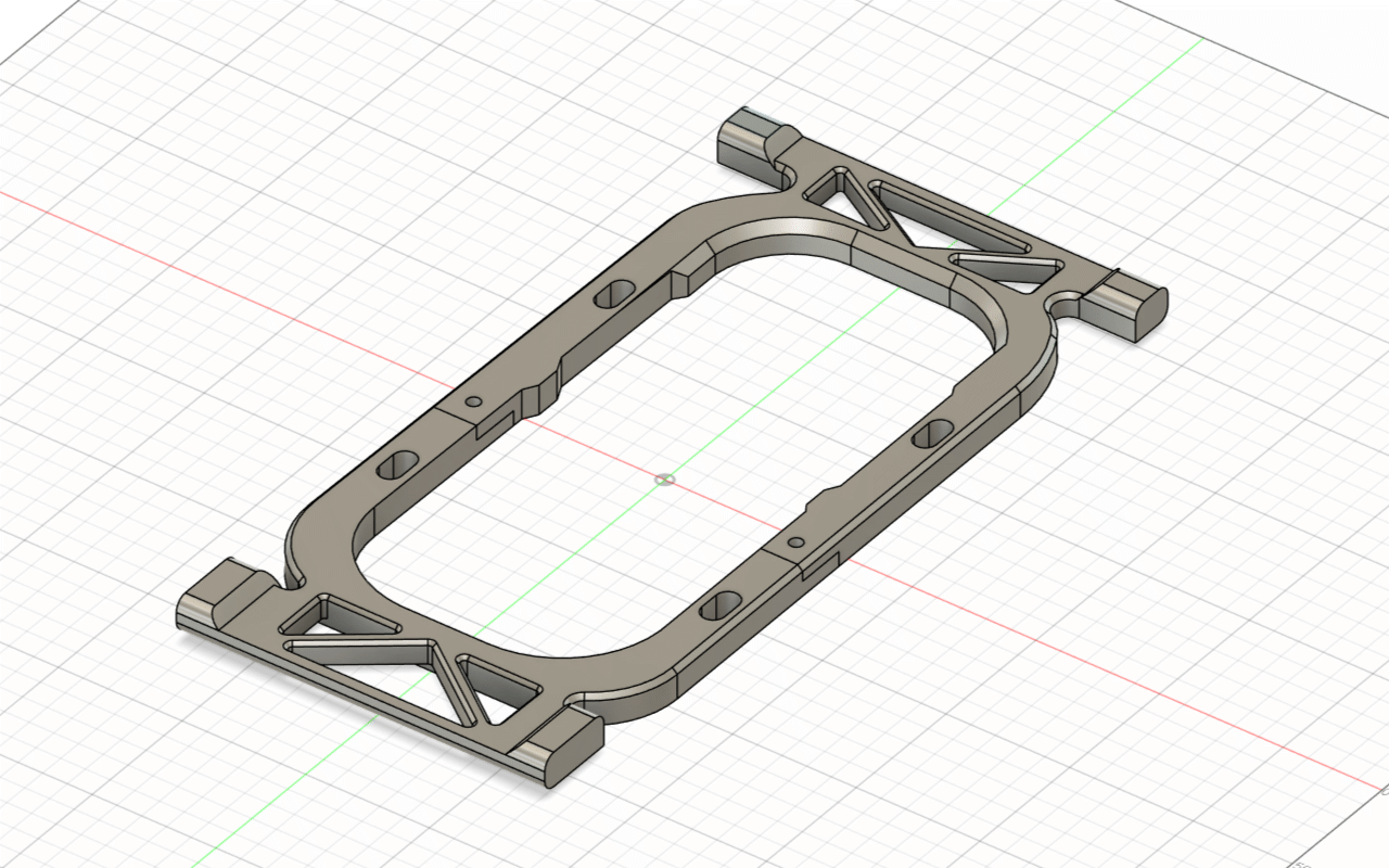

Adapter plate made in Fusion 360
Adapter plate made in Fusion 360 to be 3D printed with either PETG or PLA-CF

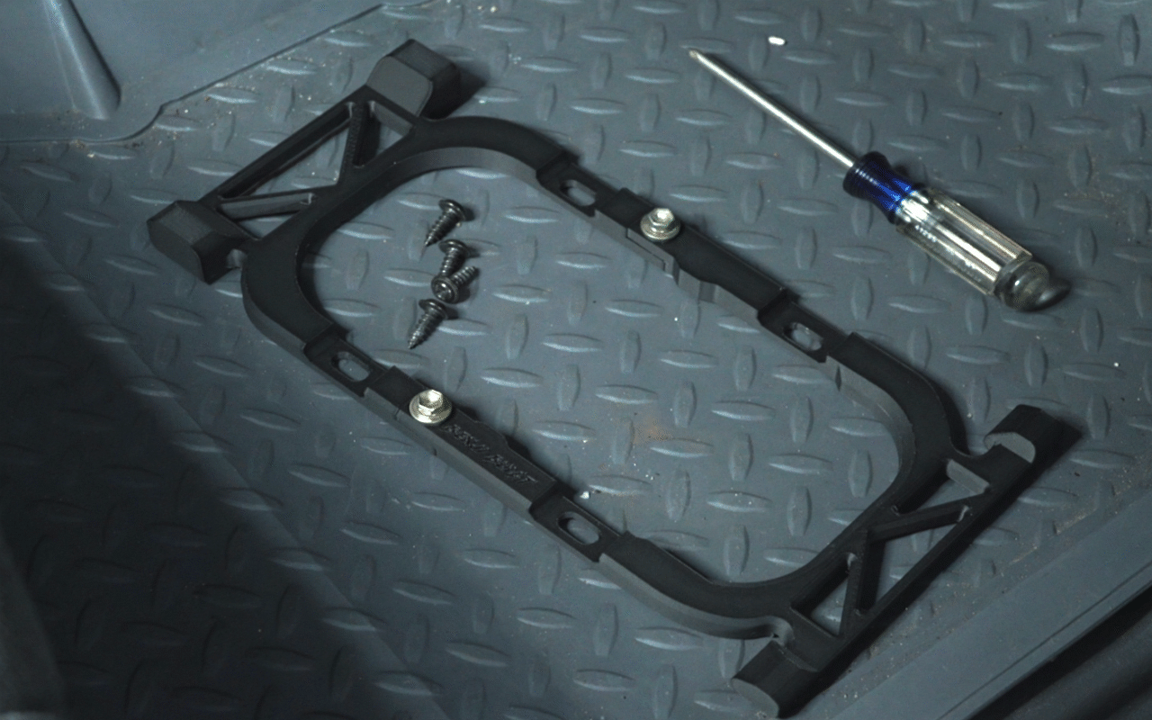

After multiple prototypes, this is the final form of the adapter. It uses two bolts to mount together and uses the OEM screws to mount to the Shifter plate.

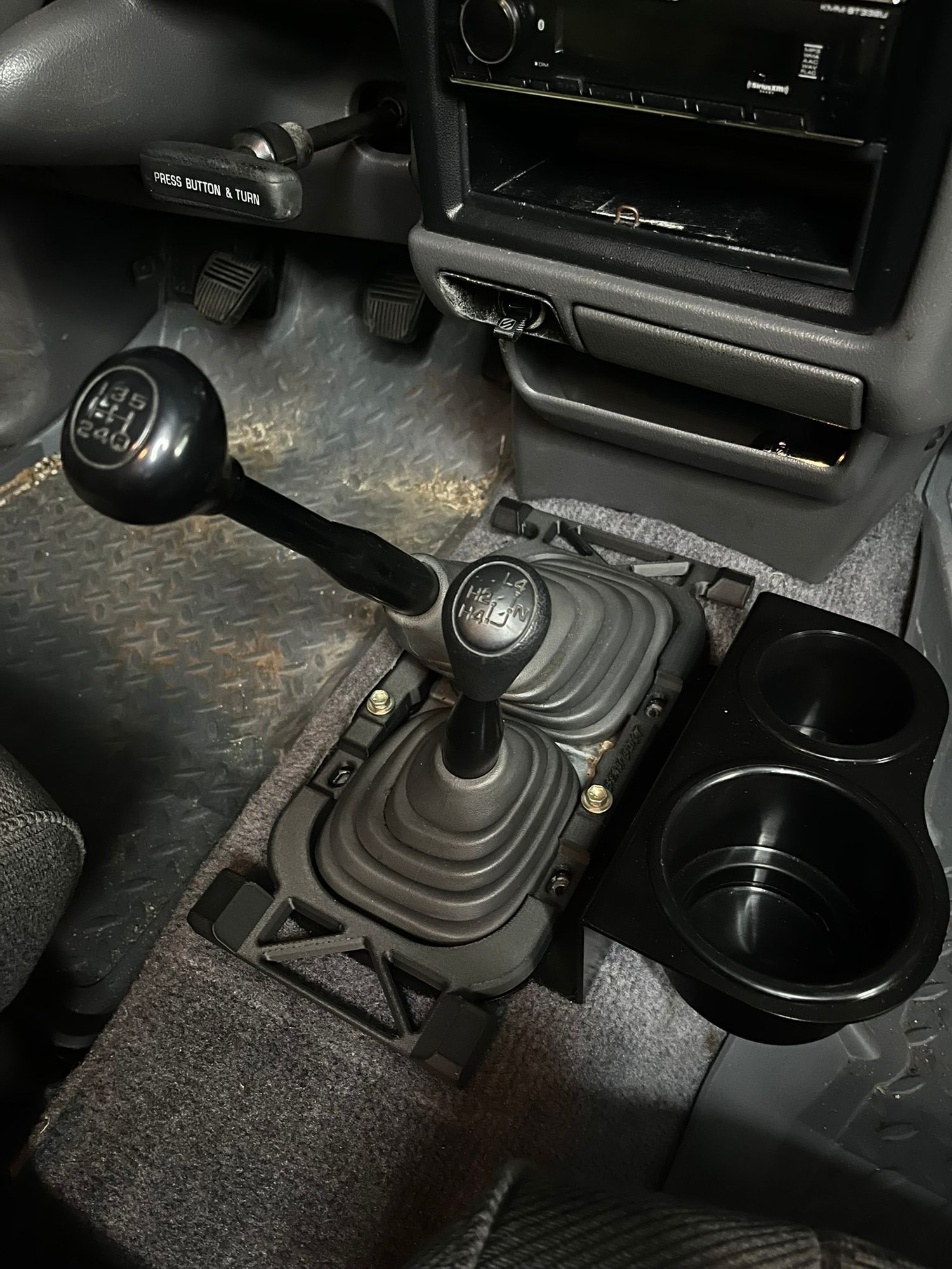

The adapter installed with JC Customs cup holder.

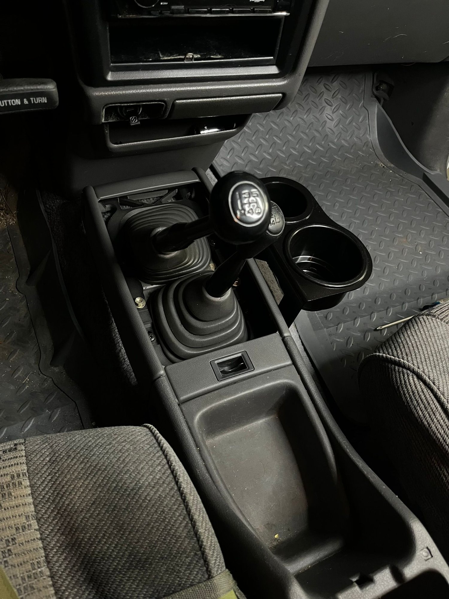

Check fitting the center console bezel and rear console.
Check fitting the center console bezel and rear console. So far everything fit perfectly. Just had to drill holes for the screws on the sides.

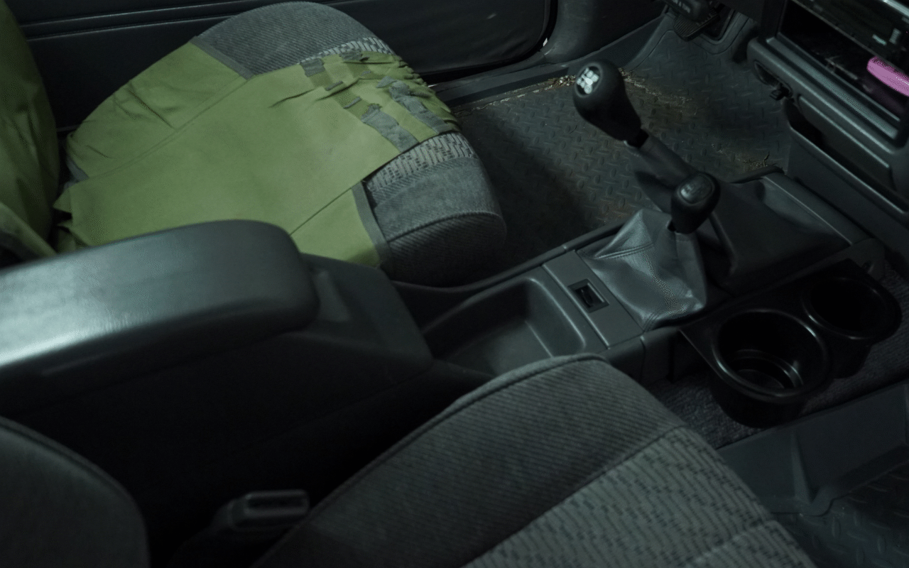

And basically it fits together like it's OEM! Really excited to continue 3D printing stuff for this truck!
final product.
Done. SR5 shift handle included. link to my Youtube channel where you can watch a more detailed video below
The SR5 Center Console conversion has been something I've wanted to do for a long time, but getting the correct brackets and a welder to do it was an obstacle. 3D printing allows me to create the parts need to make it all work, no welding or cutting required, and I added some extra cup holders along with it!
