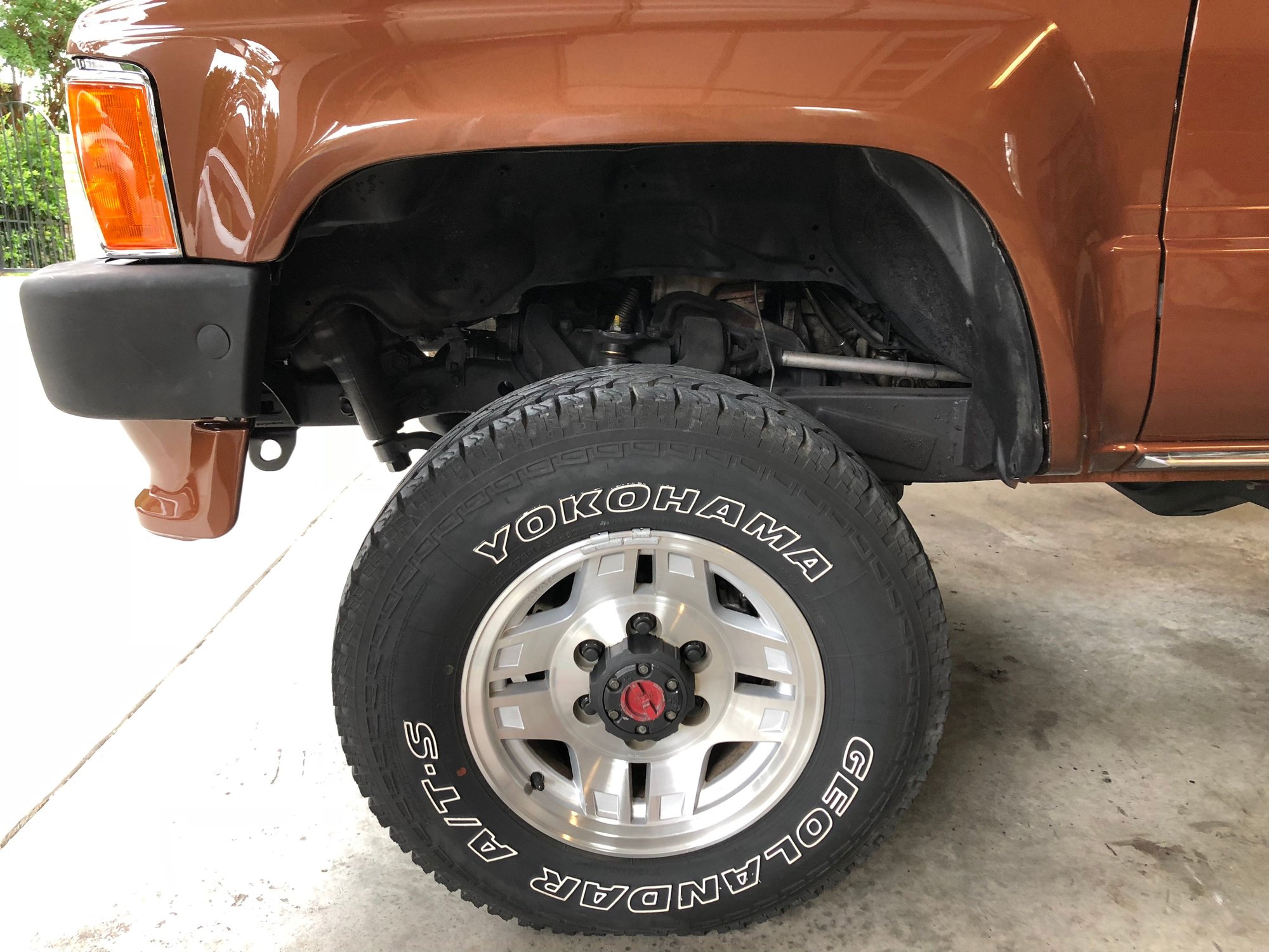

As the title says, worried about these tires rubbing when I go on Fri to get them mounted. Setup:
- 1.5” 4Crawler BJ Spacers
- OME T-Bars cranked for 1” add lift
- Upper A-Arm lip trimmed
- 235x75R15 tires in the pic
- 32x11.50 KO2s will be mounted Fri
Pica attached. Thoughts?

I don't think they will. seems like a lot of people run the 11.50's
See if the tire shop will mount just one tire and mount it on the front and cycle the suspension

If they aren't rubbing now they won't. Your tire doesn't get closer to the a arm during travel. Backspacing determines this not tire size

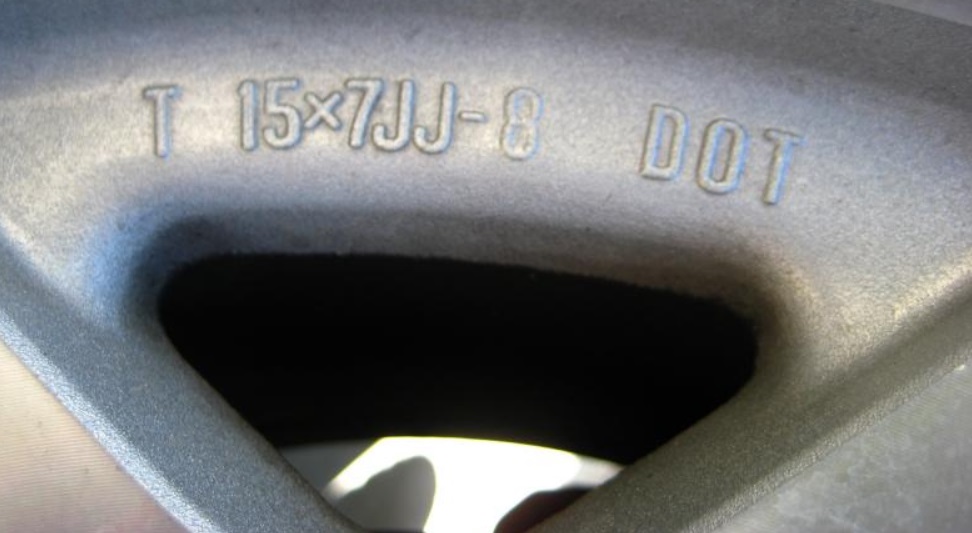

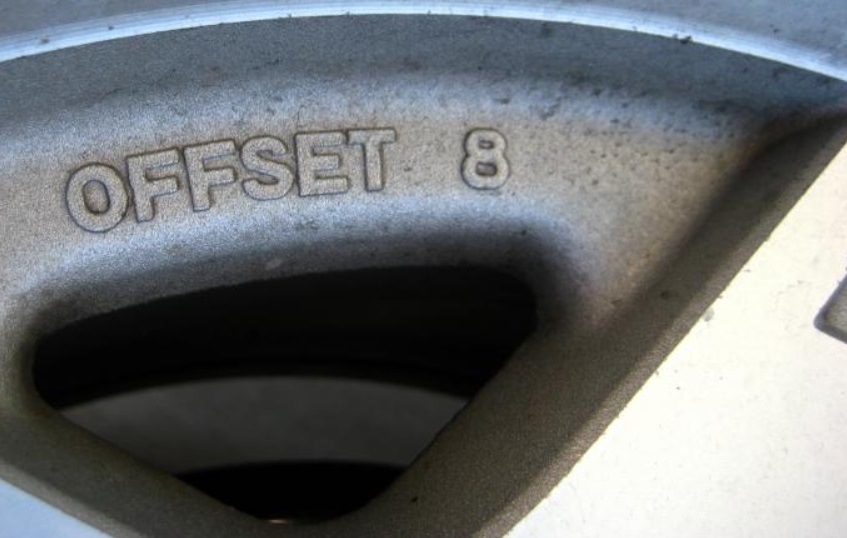

Do you have the first gen alloy rims or the second ones? They look similar, but the first ones have 15 offset and the second ones 8.
1st gen: 15x7JJ-15 DOT (if Iam correct, you don't have this info in the rims).
2nd gen: 15x7JJ-8 DOT (you have this info in the rims).
Don't quote on me this!

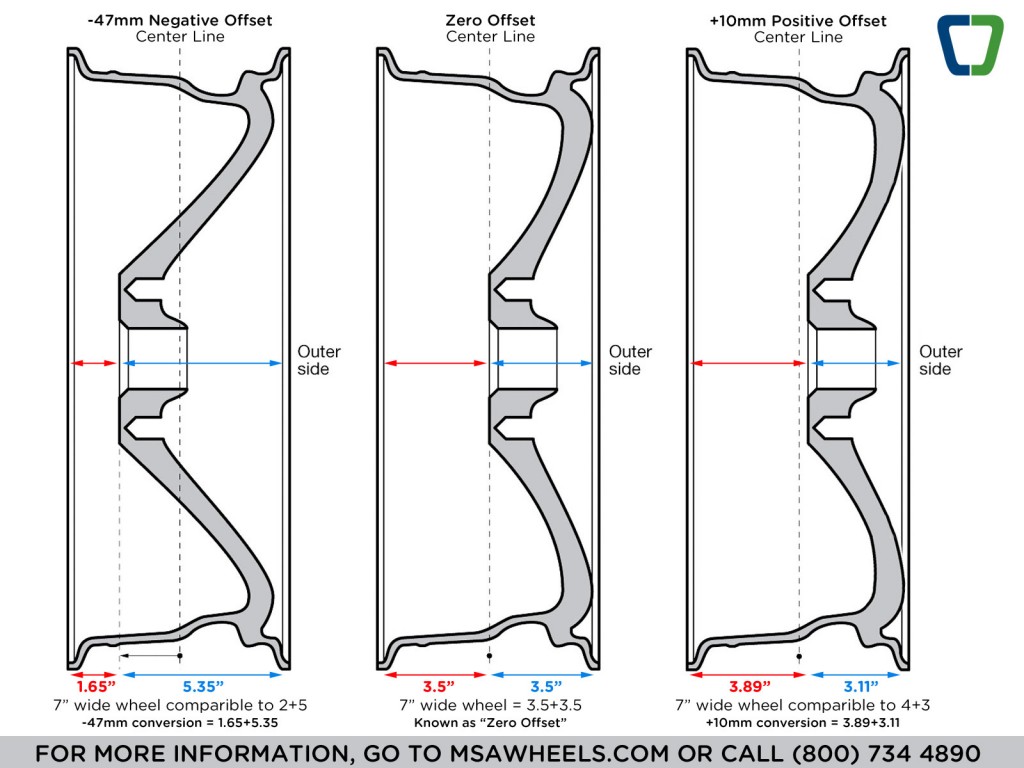

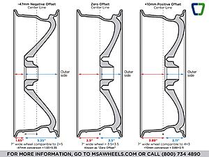

I think (don't quote me on this!) in your case, the smaller the offset the better. Negative offset 'stick out' more than the positive ones. So 8 should be better than 15.
I'm not sure, lets wait for the experts.
