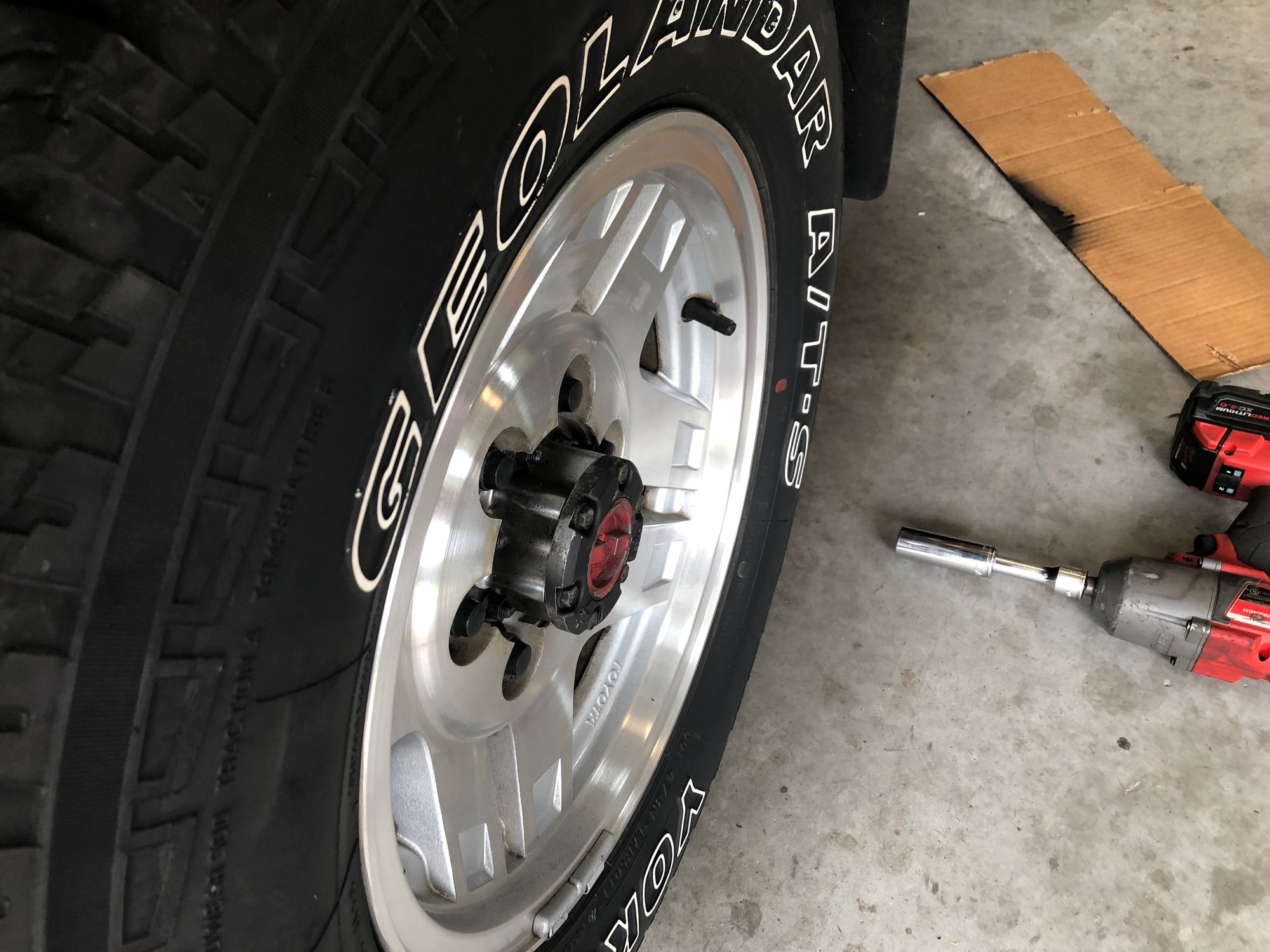

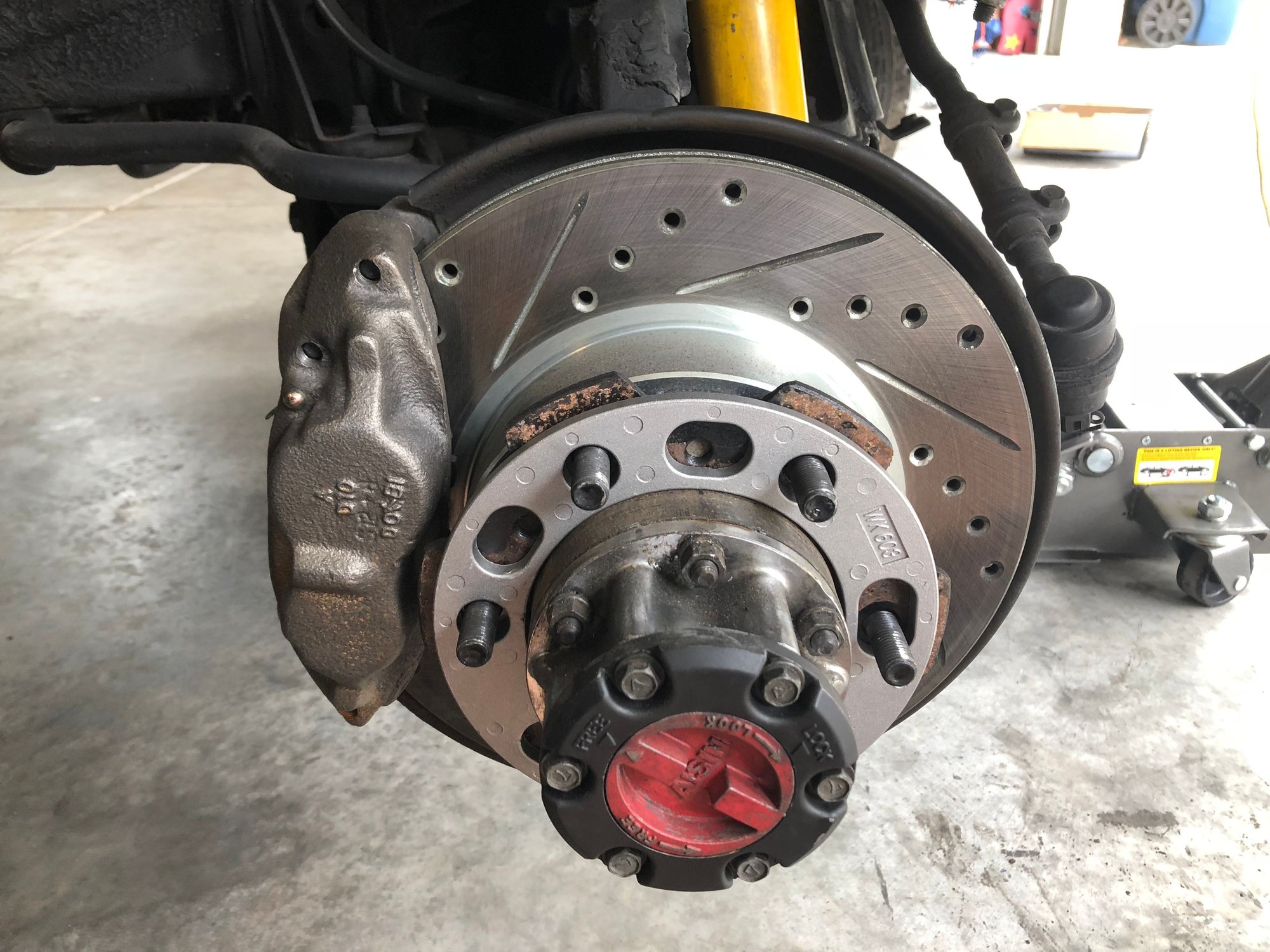

Just grabbed some Dorman 1/4” thin spacers for 6 lug. I think they will give me just enough space while keeping the hubs looking normal.

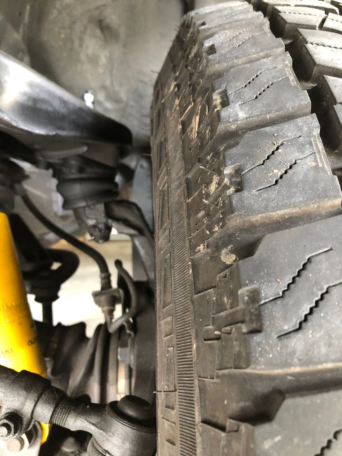

Charles - so when I originally put my BJ spacers on is when I believe the problem happened. I did not notice at first, but then after a bit of driving, I happened to see the scarring on the inside wall of the tires. Mine were just barely rubbing, enough to make a mark through the whitewall letters. I did not want to grind my a-arm and I wasn't even sure if that would be enough, so I bought the 1/4" spacers and that did the trick. If you have already ground your a-arm lip, then you might be fine, the 1/4" spacers are good extra insurance.

Great - thanks so much for confirming. I only ground the lip off the Upper A-Arm - I was afraid to touch the structural part of the arm itself. I think I'll put on the 1/4" spacers tonight and fingers crossed everything installs fine tomorrow morning.

That lip actually is structural to an extent, much like the one that gets cut off behind the ball joint spacers, the 90° junctions serve to stiffen and reinforce the flat sections. It's been covered before.
There is a small change in the A arm clearances as it travels, picture a plane rotating in a balls centerline when the plane is parallel it protrudes farthest.
A small shim is likely all you need, tape measure and some mathematics would tell you for certain..
Keep in mind the quality of the work done while installing those BJ spacers. It's not unheard of for there to be discrepancy in the cut and grind of the arms which yields different clearances on each side in which case you might need different sized shims on each side to center the rubber with the frame.

Thanks. My spacers were tight and seemed close to perfect on the each side. Hopefully the 1/4” thin Spacer and removal of the A-Arm lip wil do the trick!
About 1” of clearances now - will be close!

Truck turned out great - zero rubbing. bJ spacers improved tide quality 10x over T Bars alone! I have just enough A-Arm
spacing with the 1/4” thin spacers!

Mos Hub centeric wheel spacers are 1.25”. Per my measurements, I only needed 1/4” at most. Research showed 1/4” Thin Spacer is not ideal, but works fine. Some had run them for 12-yrs with no problems.
