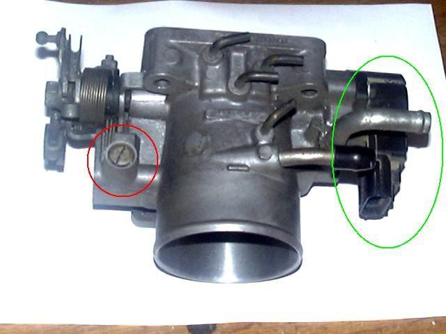

Actually, the BIG bras standard screw, is a cover for the actual idle adjuster screw. You may be allowing more or less air to flow into the area of the actual idle adjust screw by adjusting the cover screw. If the o-ring on the IAS is failed, that might well adjust your idle.
You might want to take the cover screw off, and pull the IAS to check it's o-ring. They're a known failure item and very available, and easy to change out. Let's face it, rubber only lasts so long. Make sure you screw the IAS down till it stops, counting the turns, including fractions there-of, so that you know where it was the last time it was working right. It's a good starting point, anyway.
As I said, the o-ring has a problem with disintegrating. If it has, you'll need to clean any bits, chunks, etc out of the small little air passages the screw controls. It's just generally a good idea to give the air passages a short squirt of carb cleaner, just for GP.
Not the greatest pic in the world, but the Idle Adjust Screw COVER is circled in red. Remove that, and the actual IAS is a smaller, brass screw down inside.
Didn't know that. I will have to take a look at mine.
