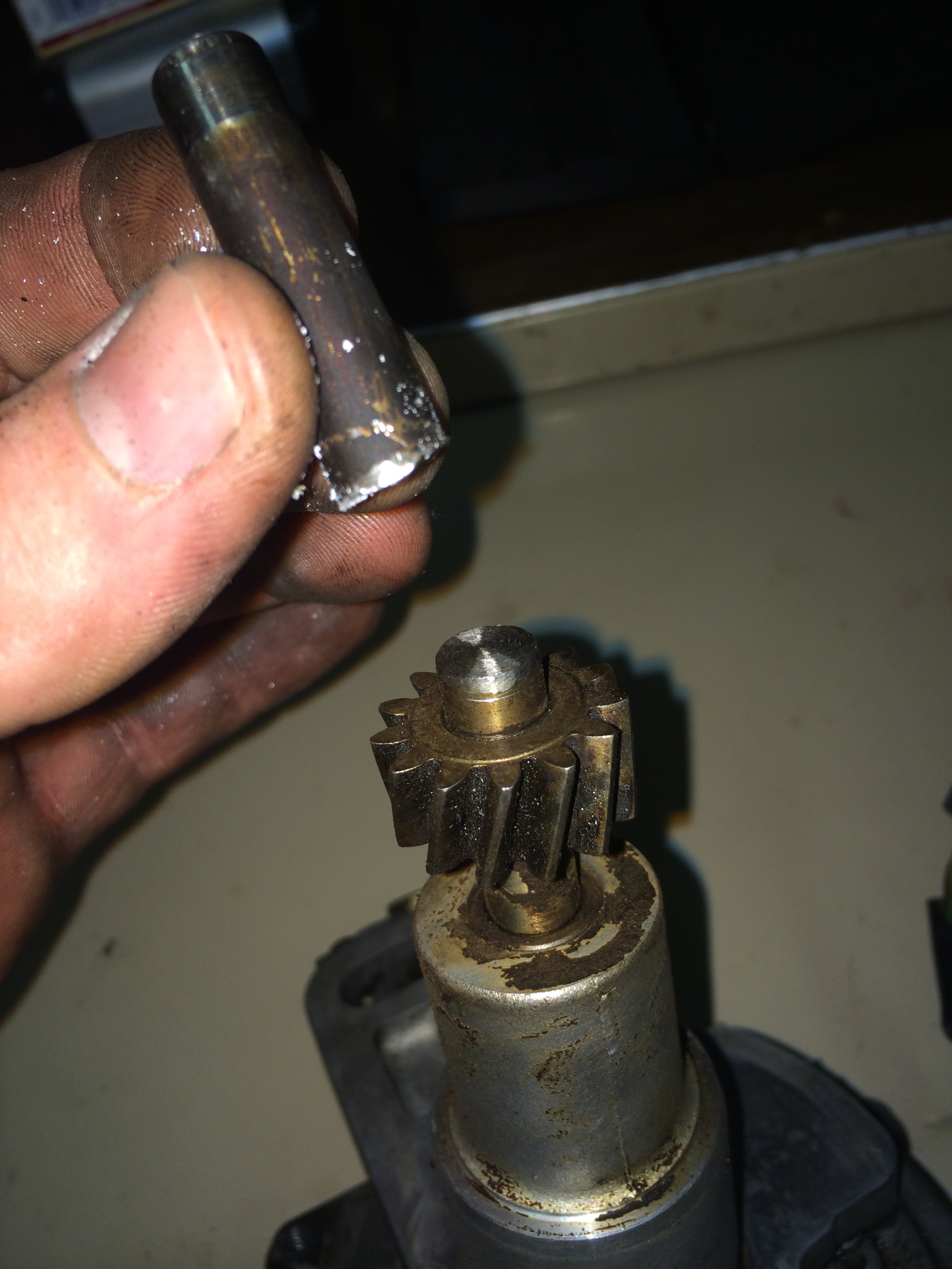

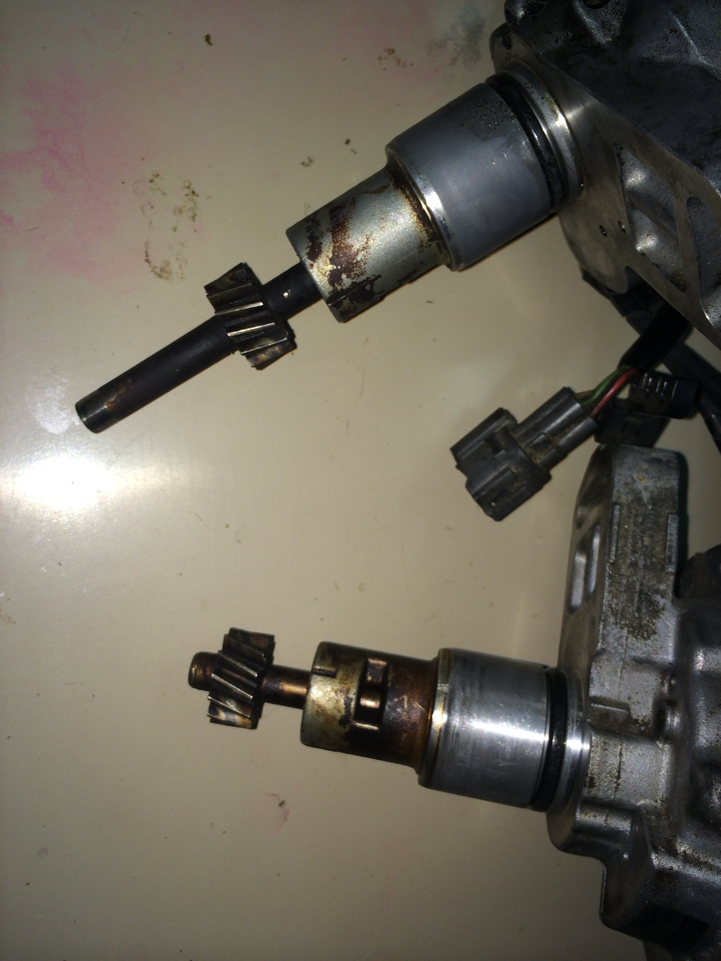

I did build the engine, this is completely my fault. But not so fast! The engine is from a 95. the 95 distributor has a shorter shaft that doesn't reach down far enough to sit in the pilot hole. This leads me to believe that the other head's pilot hole is most likely not drilled out either.
This means, theoretically, that the heads have a chance of not being swapped.
so now its just a matter of making a wiring harness to got from my 91 harness to the 95 distributor.

Problem solved. I whacked off the end of the 91 distributor shaft. Hope my theories are right! No harness needed. Its easier to give it a shot than to rip that motor apart.!

everything is exactly the same as far as gear placement and body are concerned. the internals are different. I guess in 95 they decided that that end of the shaft didn't need support.
