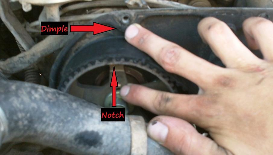

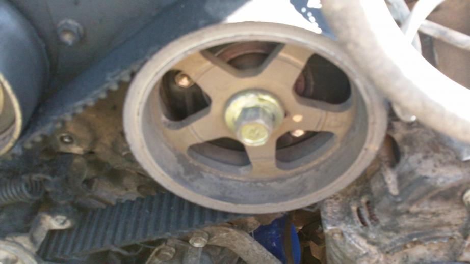

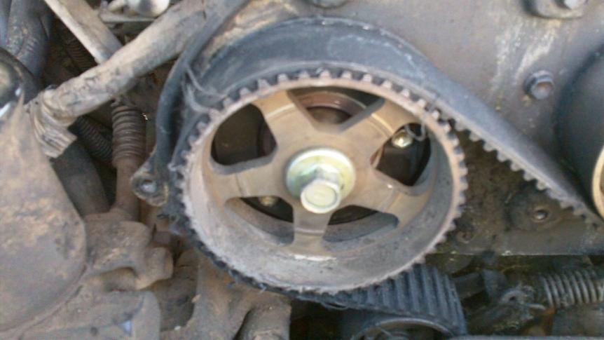

TBelt Pictures
I tried the carb cleaner trick, no dice. Pulled plugs, little dirty but not too bad. Injector pulse checked.
Haven't read up on how to check the timing but I went ahead and got the cover off to take a look. I have some pictures in case it's possible to see if my timing is off just from them...The pulley on the passenger side has a dot on one spoke and it happens to be @ the 6 O'clock position. Driver side pulley has a dot and an arrow and that spoke is @ about 4 O'clock.

Timing belt look like it need to retired.

Now that you have the timing cover off, you will see a dimple in the metal at the 12 o'clock spot, behind each of the timing sprockets. Rotate the engine with a wrench on the crank bolt till one of the sprockets lines its mark up with one of the dimples. The mark on the sprocket will be a small notch, or a groove.
When one of the marks lines up, the other better line up with its dimple, or you have a cam phasing problem.
This means the belt has skipped one or more teeth, and must be replaced.

Thank you for the info. I will try this after work today. Tearing it down was enough for me yesterday, I can't wait for "winter" to come!
After taking another look at the cam pulleys, it would appear that one is on backwards....? Pass side has a lip to the rear and drivers has one but in front. This is correct?
Old Aug 11, 2010 | 04:35 AM
  #51
blake.nemitz's Avatar
Joined: May 2010
Posts: 1,517
From: castle rock
yea one is supposed to be that way, backwards like that

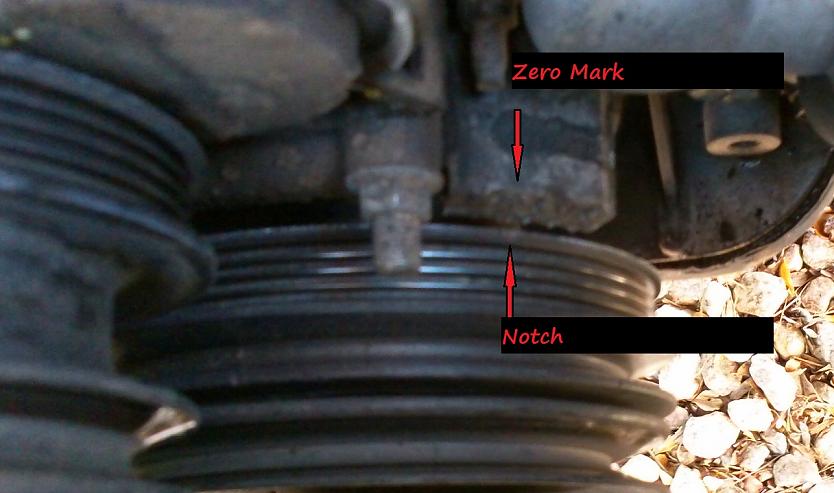

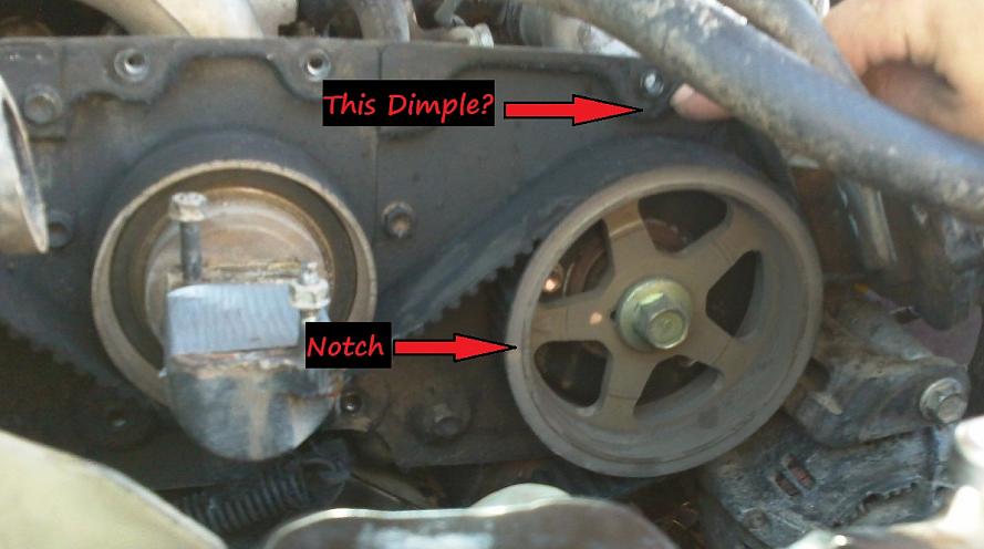

So, I just got home and figured out how to turn the motor with wrench. Lined up the pulley down low (crank pulley) so that the notch was aligned with the zero.
I'm not quite sure if I'm trying to reference the cam pulleys off of the correct "dimples" though. If so, then the passenger side is where it should be and the drivers side is around 8 O'clock rather than 12.....

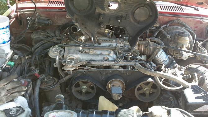

More pictures;

wow.. looks like ya may have jumped time, but seeing the shreads on the tb... i'm not suprized.

Dont be so sure! It only lines up perfect on every 4th revolution! I think its 4

i would cycle it 3-4 times.. and if you dont line up you dont line.. up bottom.. line
buy a new belt and a new belt tension kit replace all bolts and lock washer to prevent loosening of bolts in future..
retime engine and motor away for a few hundred thousand miles....
