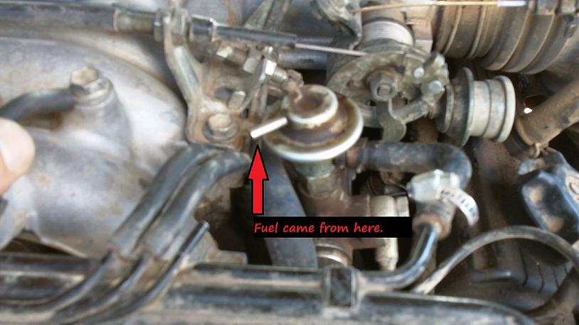

Hey all, I've not had much time this week to do much with the truck. I've not yet check compression or timing, still hoping to stumble across a bad wire or something easy.
Anyway, I removed the top hose from the FPR which I assume is a vacuum line, and there was fuel in it. Could a faulty FPR be the problem? I would think it would still run, just not so great but perhaps I am wrong?

That injector spinning is normal. They just pop in there with an o-ring and spin on most any car. Those exposed wires are not the problem but need to be repaired and covered.
The "device" you pointed to upon the fuel injector video thats above the injector is the Fuel pressure regulator. Sure its gas leaking around that area and not coolant from the throttle body coolant hose? Leaking gas is never good to have as it can cause fires as well as a fuel pressure drop.
You need to just shoot a hit of carb cleaner into the intake and see if it will run and continue running upon more carb cleaner injection. If so more that likley its the fuel pump or an injector signal issue. Not having any other codes than tps its prob the fuel pump.
Cranking time and speed seems normal and ok.
Timing belt more than likely not the culprit.
The videos sound is kinda odd on my computer though it could have "jumped" time.
Removal of timing cover and inspection may be in order.
There should not be fuel coming out of the the vac port in the FPR. That indicates the diphram in the fuel pressure regulator has more than likely a small pin hole or two in it. Needs to be replaced. Usually on toyotas and older vehciles it will still run with the FPR unplugged. But if theres enough fuel leaking past it that "manifold vacuum" is pulling unmetered fuel it will cause some of these symptoms your having. Its accutally prob flooding a lil as well.
Try starting the truck with the fuel pressure reg unplugged now that its not pulling in the extra fuel. You may have to give it a few throttle "pats" and a few Cranking times to get it to run as it may be flooded.

I don't think it's the pump because fuel gets to the rail (at least the one under the intake plenum). I know because it'll come out the cold start injector hose if disconnected.
What about the FPR, pretty sure it's faulty, could this cause the type of failure I've experienced? I plan to do the carb cleaner test either tonight or sunday, hard to say but it has to happen eventually, no wheels is no bueno!

Well then. There should be no fuel coming out of the top hose. You should get it replace. Junk yard sale them very cheap. Test it with a junk yard FPR and see what happen after that and see if it work...
