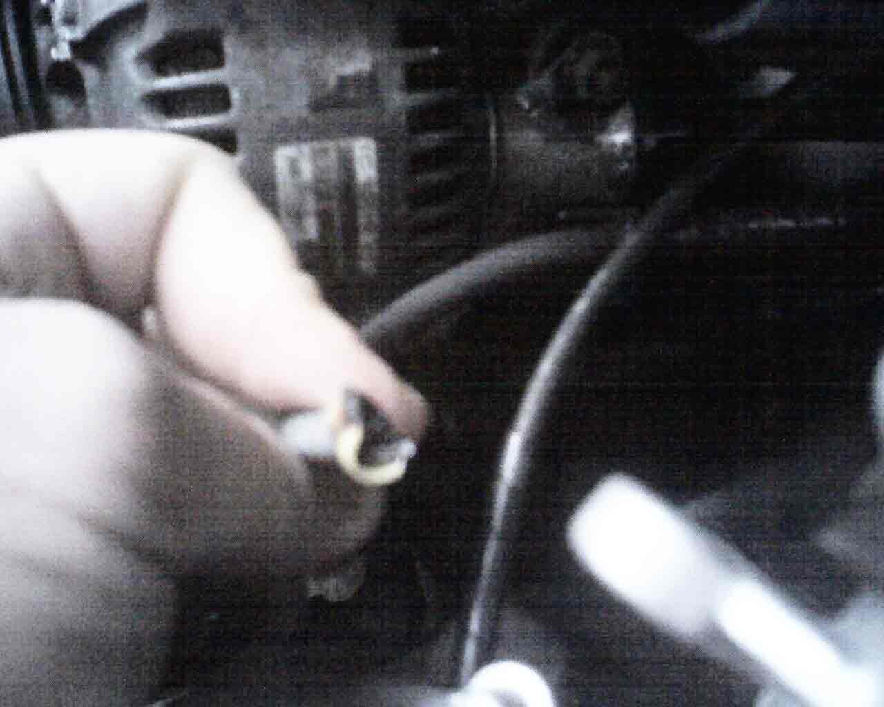

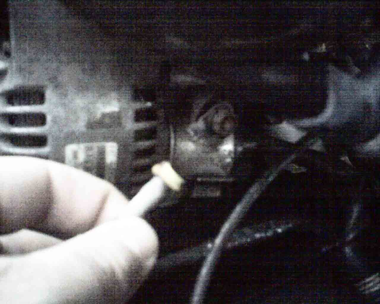

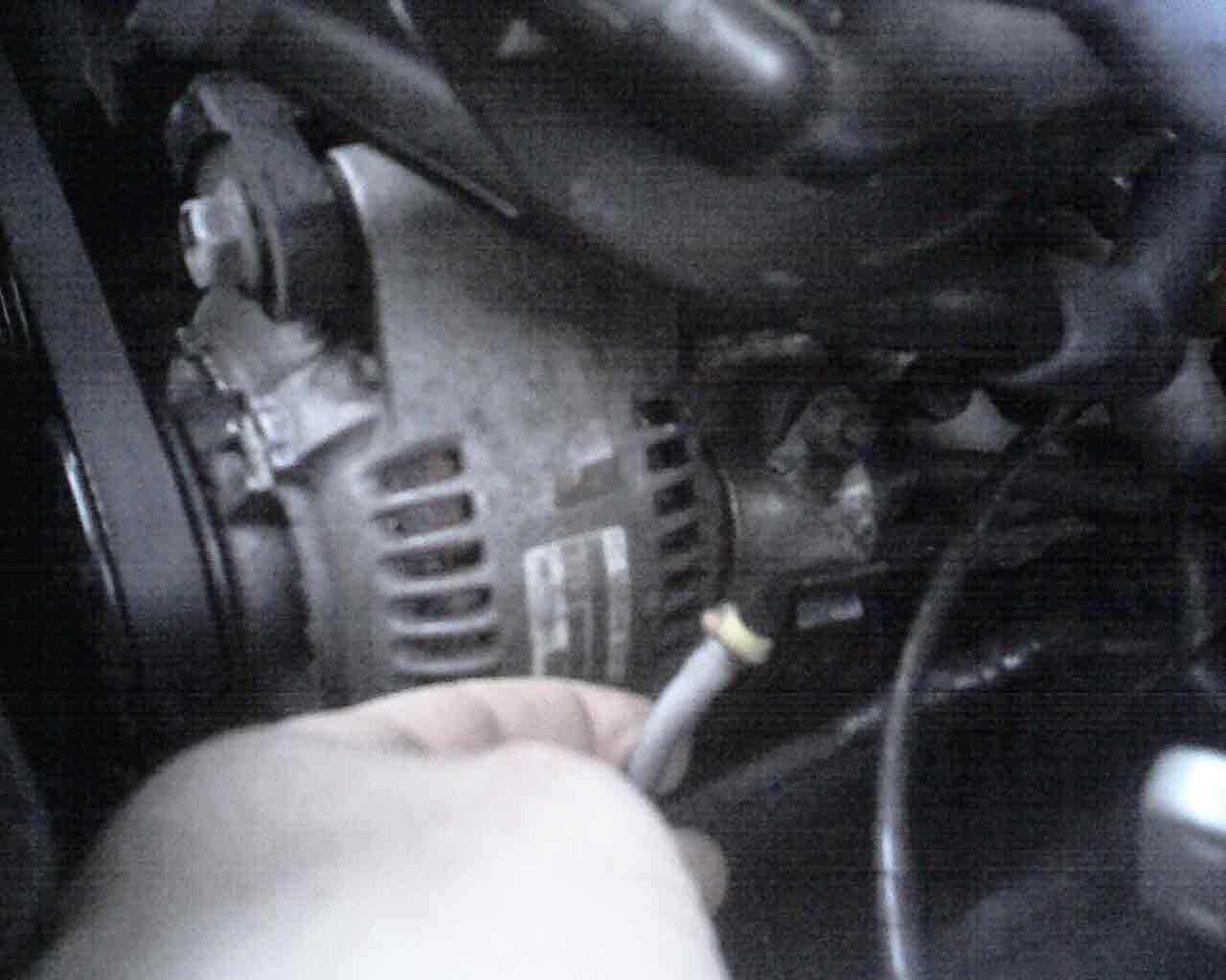

This morning I was greeted by the brake light/battery light combo. Considering there's a brand new Odyssey I don't want to damage it so I returned home to investigate. Initially I thought I needed a new alternator so I started reading all the posts about mean green, learned that boyle's future technology rebuilds may be the way to go? I called the guys there and they seem really cool, their brand new rebuilds seem to be a good bit cheaper than the mean greens, nice guys too.
anyway, before jumping the gun and ordering something I wanted to check the wiring and see if anything jumped out at me. well something did, the main battery wire from the alternator has come off. The end is somewhat charred, looks like it was a loose connection...or could it be more sinister than that? I hope it's an easy fix.
What would you recommend as the first step in reattaching this, will it need to be soldered/crimped, new wire, is this something I can do, I am somewhat wary of working with soldering guns in the engine bay. pics are attached, it was a bit dark, I tried lightening things up in photoshop for easier identification, apologies for the poor photo quality (cellphone).

ouch looks like you had a big load in that thing well this is what i did cheap easy and can put up to a heck of a lot more then the stock ok here it goes go to a radio shop get about 6 feet of 4gag power cable color of you thinking then spend about 10 more bucks and get hammer on conectors get one with a big hole and one with a small hole to fit the alt then strip the wire at both ends hammer on the conectors tape over the ends and bolt her on good to go seeing that the input power wire is fine and the alt gets power? ill see if i have a pic hang on ok its not that good but it shows the wire and one of the conectors and most of the route i too to put it in

thanks so much 22re, thanks to your help I was able to upgrade the big 3 wiring today with my friend, gauge4 wiring from alt to battery , it is SO much more sturdy and thicker than the stock wiring which was puny, old and brittle. (not to mention burned right off at the end!) Now there is also a 4gauge ground to engine block and ground to body, in addition we put in NGK wires and NGK iridium plugs. not only that I did a seafoam treatment, topped up all fluids, and then took a drive, and I was very happy with the result thanks again!
