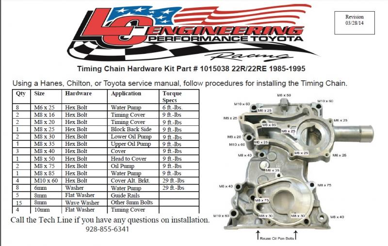

I found this graphic on the web, it specifies 6ft-lbs for the 6mm bolts and 9ft-lbs for the 8mm bolt:
http://www.skjos.net/toyota/images/t...ver-torque.jpg
So take your pick at which torque to use, but the 6mm bolts should be no greater than 9ft-lbs and the 8mm bolt no greater than 15ft-lbs.

LCE Flyer on Bolt Specs & Torque Specs for 1985 to 1995 22R & 22RE Water Pump & Timing Cover: http://www.lcengineering.com/LCInstr...ware%20Kit.pdf
