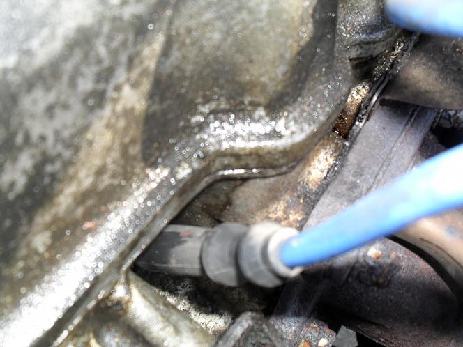

Here's a few pics of the chips on the head and one pic of where it appears to be seeping through. I don't know if it was leaking this bad before or not, it might well have been. The rest of the cover is sealed up pretty good, I'm thinking about just putting some black RTV on the outside where it's leaking and see how that holds up.
The chips are small but they are the only shiny sections where the head meets the cover.

like I said, i took a plastic spackle knife and drove it in under the cover in the area of the passenger's side front by the hoist hook thingy to break the seal.2 knifes rammed in there and you could probably wedge a good size straight edge screwdriver in between them. I wouldn't pry against the head anymore though...it's only aluminum. doubt you did any hard there though.

I'm definitely not going to pry anymore. I'm going to try to get it done tomorrow I guess with the help a pretty savvy friend. I bought some black RTV, if I don't change the half moons should I dab some of that on them?

we didn't take the grommets out the other day so I think that was the problem, Tomorrow I'm going to try hitting it with a rubber mallet after I get the grommets out and I picked up a couple of razor blades too. I won't be doing any more prying.

Got the new gasket on today and sealed up nice with some black RTV. Also, my timing chain guides are intact and everything looks nice and clean under there. I'm pumped. This truck was definitely taken care of. Now, all I have to do is bleed my brakes tomorrow and then drive to California next month. I think it will make it.
The valve cover came off no problem after I unscrewed the grommets.
