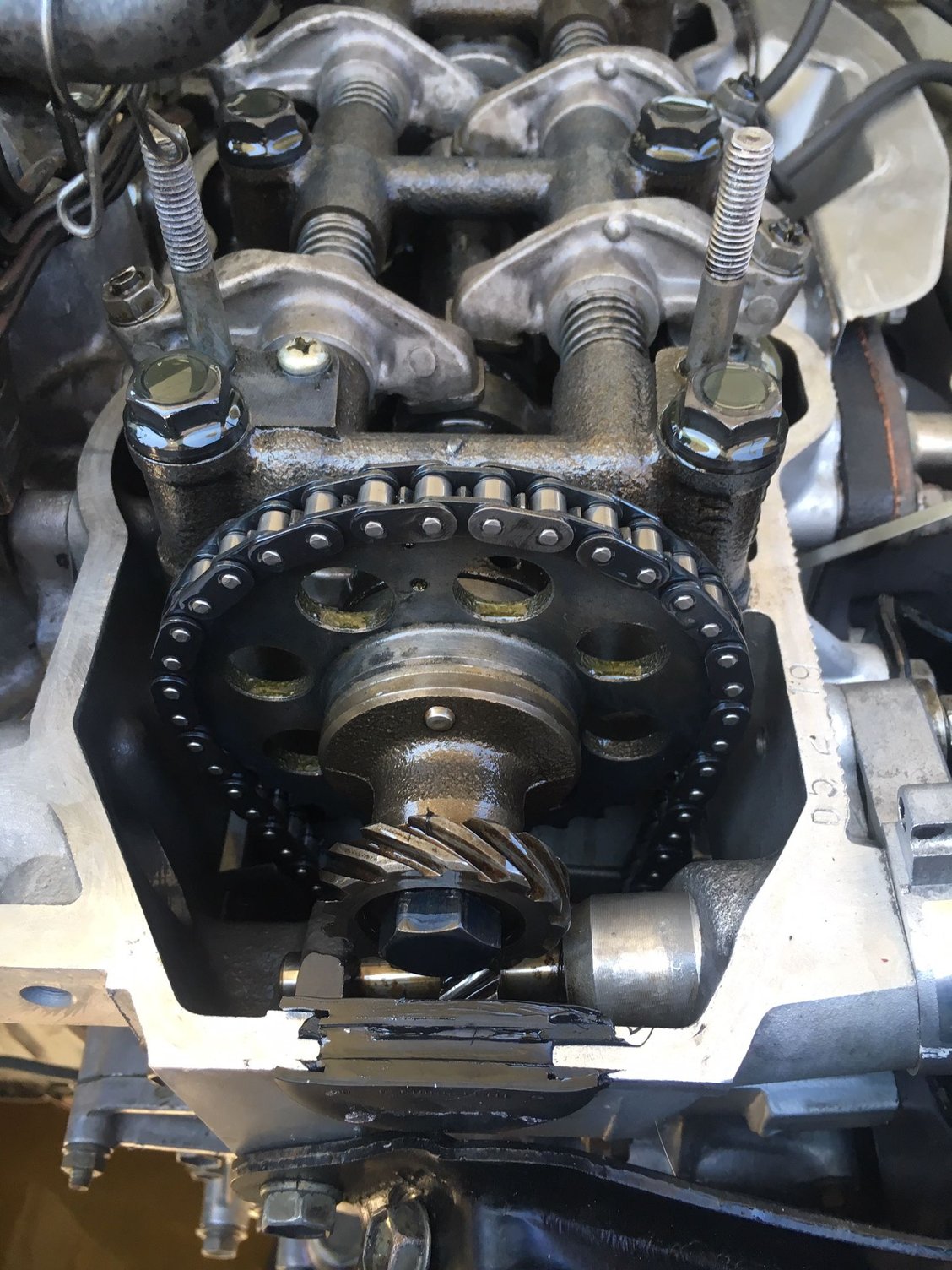

I did ended up finding the time to work on the truck this weekend and found out that the distributor was off by one half rotation. I also pulled the valve cover and saw that the chain may have jumped a tooth? So I'm assuming I will have to go back in and repair that. Now I am curious to how could I find out if I may have damaged valves while previously trying to start the engine?
Timing chain jump

Are you sure? If the distributor was "180° out", the plugs are firing at the top of the exhaust stroke, and I can't imagine it would even fire, much less run.
Originally Posted by dychron
... how could I find out if I may have damaged valves while previously trying to start the engine? ...
A compression test will give you a good indication. A leakdown test would be more useful (you don't need the fancy gauge, just the compressed air, as all you're really doing is trying to listen for escaping air when the piston is at TDC on the compression stroke.)

Just like timing belts, the timing marks (bright links) on the chain are not really relevant after the engine has been rotated. The bright links are only there to make sure there are correct number of links between the crank sprocket and the cam sprocket when the chain is being installed. Because the chain is not the same length top to bottom on the tensioner side compared to the driver's side, the bright links will rarely line up with the marks on the sprockets after the engine has been rotated.
To check if the mechanical timing is still correct, look to see if the crankshaft pulley and the cam dowel pin are both straight up.
So I did a leak down test today and each cylinder checked out within 10%. The chain bright links varying after turning over the engine is news to me but it seems that the cam notch is aligned with the crank mark. Any advice on where to proceed?
