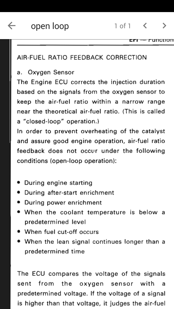

One of the books does mention it exits closed loop when cold, and when receiving a more than 3/4 throttle signal.
18 isn't horrible.
18 isn't horrible.
That's exactly the information I'm looking for, thank you!

"Power enrichment"
"Power enrichment"
Of course the computer would need to run lean. Instead, it sounds like it richens the mixture at high throttle settings to produce absolute maximum power...I mean who wouldn't, in a 100HP truck?
