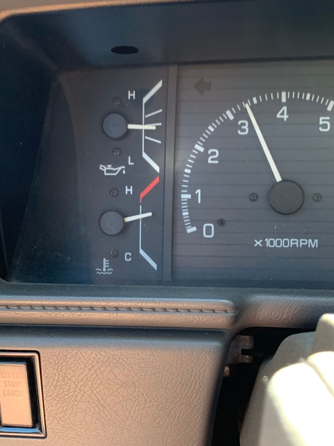

I have a 1987 4Runner SR5 with the 22re engine. The factory temp gauge will creep up to the 3/4 mark on uphill grades in warm ambient temps (90+ degrees). The engine was rebuilt and the cooling system remained stock. Before the rebuild the gauge never moved past the halfway mark.

The factory temp gauge has always acted funny since I bought the 4Runner 7 years ago. On a cold start it immediately goes to the halfway mark. Very rarely does it stay low and move slowly up to temp like a normal gauge. So it is strange that is is able to read hot.
Any thoughts? Could the over bore cause the engine to run hot? It would probably be a good idea to get an aftermarket temp gauge. But I want to use the original.

Is the gauge actually reading the temperature of the truck? An inexpensive IR thermometer from HF, pointed at the thermostat housing may tell the tale. If the gauge isn't accurate, is it the actual gauge, or the sensor?
