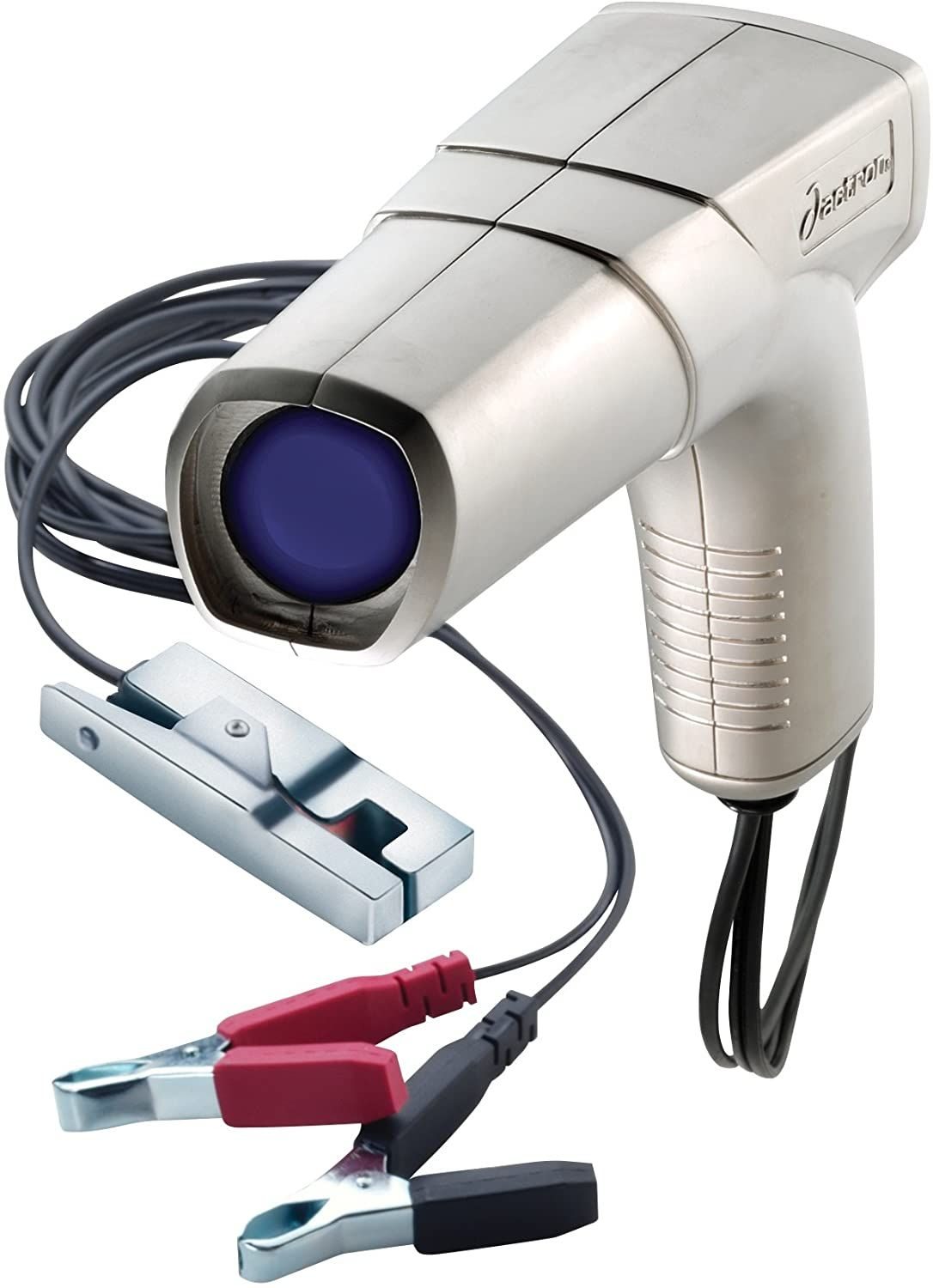

Quick question.. can bad timing cause my engine to overheat in this situation? I've been looking in some other forums and I'm getting mixed answers. Some people say the pinging is a cause of overheating engines, and some people say it can cause the over heating.
When I am driving uphill (even when my car isn't overheating) I'm hearing something I assume is pinging (dice in a cup) when my car is under load.
I haven't checked the timing on my engine yet. Might stop by a shop to see how much they charge to do that, or see if a friend has a gun I can borrow.

"Bad timing" cause overheating. Short answer - Yes. You say that yours may have "pinging" evidenced by "dice in cup" sound under load. That sounds like preignition, spark knock, pinging, whatever it is called. Here's the general deal: If your ignition timing is "retarded" (occurs later in the compression cycle) that may cause higher engine temperatures. If the "fire" in your engine's combustion chambers occurs as a detonation or explosion rather than a smooth controlled burn (in milliseconds) you will hear it as the rattle sound. If you overdo detonation, it will severely damage your engine. If you're having mild detonation, then your overheating problem isn't like to be caused by retarded "late" timing. In any case, you should deal with the detonation. You need a qualified amateur or professional automotive techincian to check it out. My $0.02
Several reasons for detonation/pinging. Too much spark advance is one of them. And don't lug the engine. You can make an engine ping (at least the older ones) by "lugging" the engine.

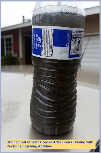

I believe in regular, intense cleaning, BACKFLUSHING, and draining. Had been doing it every 2 years now. Pretty much any acid soaking should be good. If it eats through the metal, that means the radiator is on it's way out anyway.
Prestone flushing solution itself suggest "heavy-duty" flush, leaving solution in the system for a couple of days and driving several hours. Perfect excuse for an overnight road trip.
AFTER HEAVY-DUTY FLUSH ON 2007 COROLLA USING THE RED "EXTENDED LIFE" COOLANT
