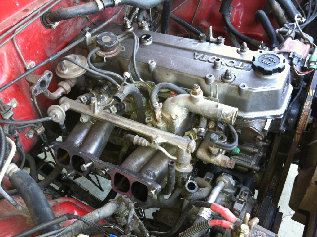

Going to throw a bunch of pictures at ya
shows the lack of anything to leak.
shows two likely suspects for rear end leaks, half moon and pinchable wire.
shows a "vast" distance between bell housing and differential.
there is a plugged oil galley tap behind the P-side engine mount.
