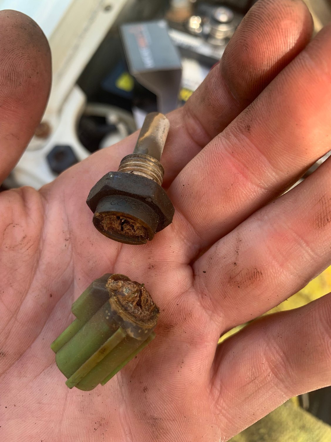

So I haven't figured out the fuel smell/possible leak yet. I worked on the truck ALL DAY and half of yesterday and still am having the same issues with the low warm idle, pinging, and I haven't had a chance to check for the smell but I will tomorrow.
I replaced the thermostat from a two stage 190 to a 180 from the rte which some guys had suggested could cure the pinging as it had in their cases. It did nothing honestly The gauge is in the same place at warm and with the timing at 5deg it pings like mad. Set to 0 and it's 97% ping free on regular grade ethanol free from costco. I might be able to get it to stop pinging at 5 with premium, but I'm just wanting this thing to run on regular and save some money.
I also tried a new coolant temp sensor the ECU one and it did nothing. I'm glad I picked it up and swapped it though because when I went to take the old one out the plug snapped clean in half! It was definitely on it's way out even if it wasn't causing the warm idle issue.
Crapped out Temp Sensor
