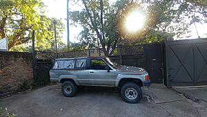

Hey Y'all, I don't have much experience with solving engine issues and hope someone might have some advice for me before I take it in to someone else to fix
Info: I am restoring an '88 4Runner with a restored/machined 22RE EFI and was converted from automatic to standard.
Recent History: Its been running great as my daily driver for 7 months now with the exception of running very rich and eating up more oil than I'm used to with modern cars (will tune up next, once issue is resolved).
Problem: After adding some fuel injector cleaning solution to the gas tank (which I think could be relevant), the truck started making a loud stuttering noise after about 1,500rpm in each gear.
Attempts to Fix: Added gasoline in efforts to dilute the injector cleaning solution. Replaced the fuel filter. Replaced the air filter.
Next Attempt: I will replace the O2 sensor next in case this is a feedback issue.
Not sure if this issue is related yet, but i'll mention that the AC/Heater Blower and AC system as a whole stopped working during my latest test drive and fuses look fine. Any feedback or tales of similar issues would be very helpful from those who know more about working on engines!
