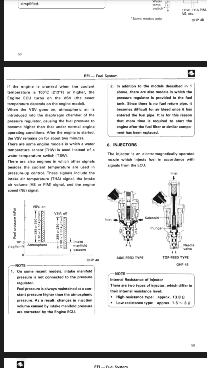

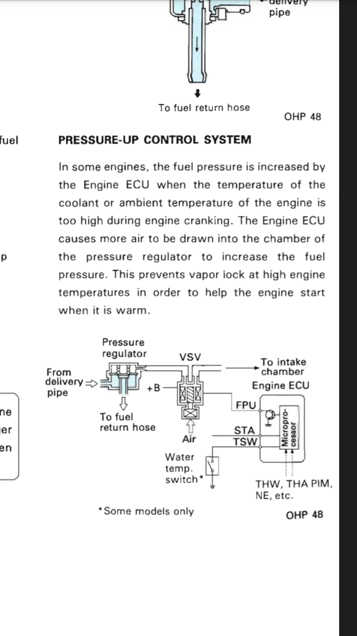

FPU (fuel pressure up system) switch on top of the thermostat controls the vacuum switch valve to the fuel pressure regulator. This gives slightly higher fuel pressure for warm restarts.
There is a TSB relates to this, both switches are discontinued from the dealership.

It's similar to the coldstart system in that it provides more fuel during start up in conditions the coldstart system isn't active.
Anyways it's just one part of the equation. It's all about air and fuel in the right proportion at the right times.
If you do not have air leaks, if you don't have leaking injectors, if your throttlebody functions repeatably, and if your idle valve functions correctly.. You have faulty sensor data most likely, which are typically due to bad power and ground or faulty connection or wires.
