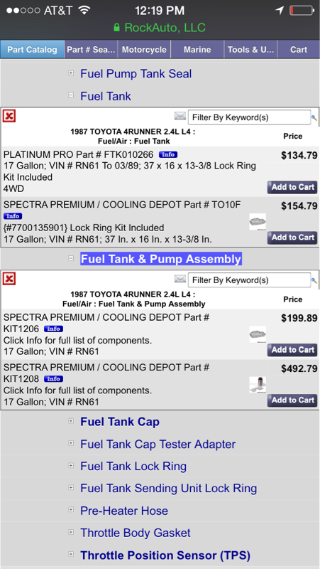

Originally Posted by kcaudill
YEah easy, replace it
Attached Thumbnails 22re hesitation/miss-image-3219133435.jpg

that'll do it! i always feel better fixing a problem that's known rather than diagnosing a problem that's unknown. at least now you can estimate the time and money required to fix it.
if the inside of the tank is rusting then i would replace the tank rather than trying to fix it. a replacement, even a new OEM tank is very affordable in comparison to the materials and time to try to coat the interior of your tank -- and if you miss a spot, then you'll ruin another expensive pump and other components. OEM tanks are $170; junkyard and aftermarket (eg. Spectra) will be cheaper (more for cold-weather option).
there are three sizes of tanks: 14.5, 17.5, and 19.5 gal -- as best as i can tell these are for, respectively, most pickups, 4runners, and lastly pickups with long bed or xcab depending on the year, perhaps for auto transmission only, it's unclear. of course, in the toyota catalog they'll be listed in liters, not gallons.
they of course vary in their ground clearance. so if you want the most ground clearance, get the smaller tank; conversely you can upgrade your capacity if you need it. the mounts are all the same, however the skid plate and sending units differ in length. i've been considering doing a 19.5 gal tank swap for my 4runner so i did some reading (but found only limited information) -- i normally don't have details like that at my fingertips!
certainly you should also replace the filter (at motor). I'd pull and clean the injectors and flush the fuel lines. i think you can simply disconnect the fuel line at the rail and jump the P+E terminals (or was it F+B?) to get the fuel pump to go. Check the FSM to confirm; my memory fails me.
If the injectors are a bit clogged, you'll have uneven flow and compression. Your motor won't run smoothly because of the imbalance and your fuel economy will suffer. In the long run, it's better to do it right. Injector cleaning doesn't cost much although you'll have to wait a week to get them back. Or to speed things along, you can try cleaning them yourself with a container, solvent, and some jumper leads, although I've never tried. Since you've probably got CHUNKS of rust, i don't think the ultrasonic cleaning is absolutely necessary.
