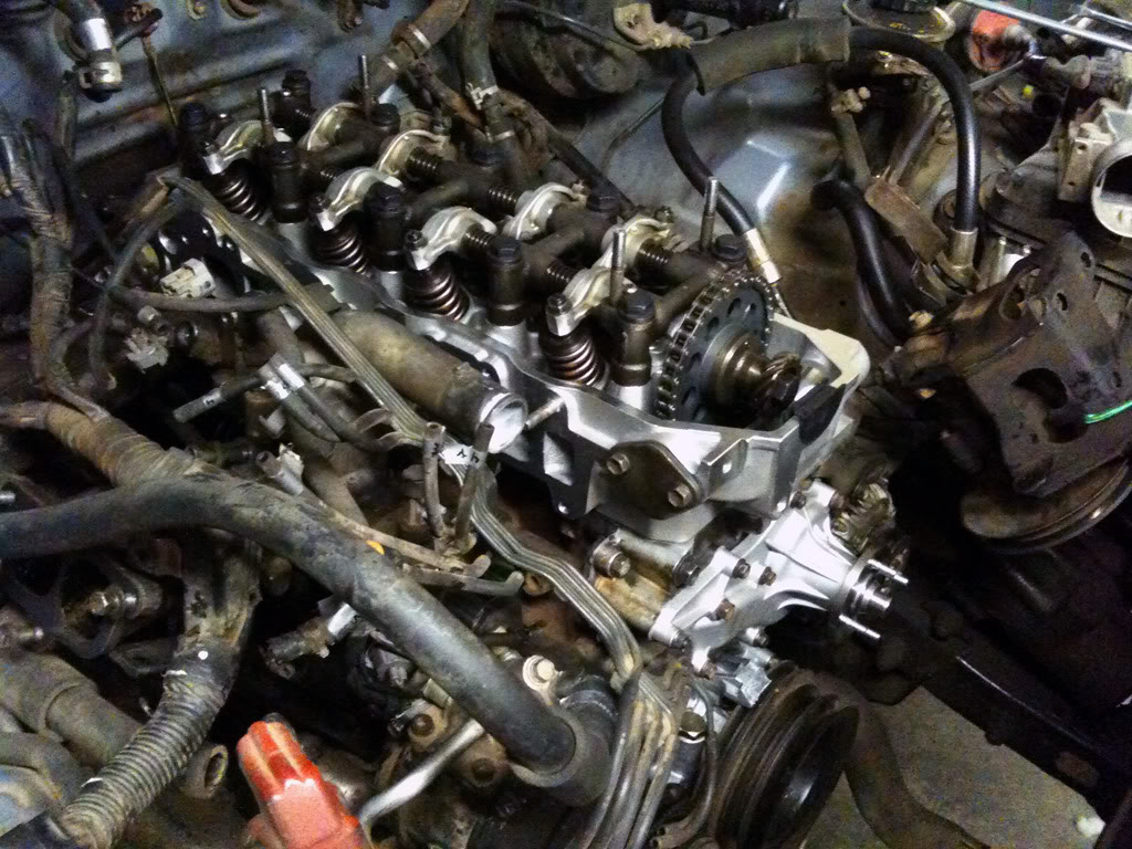

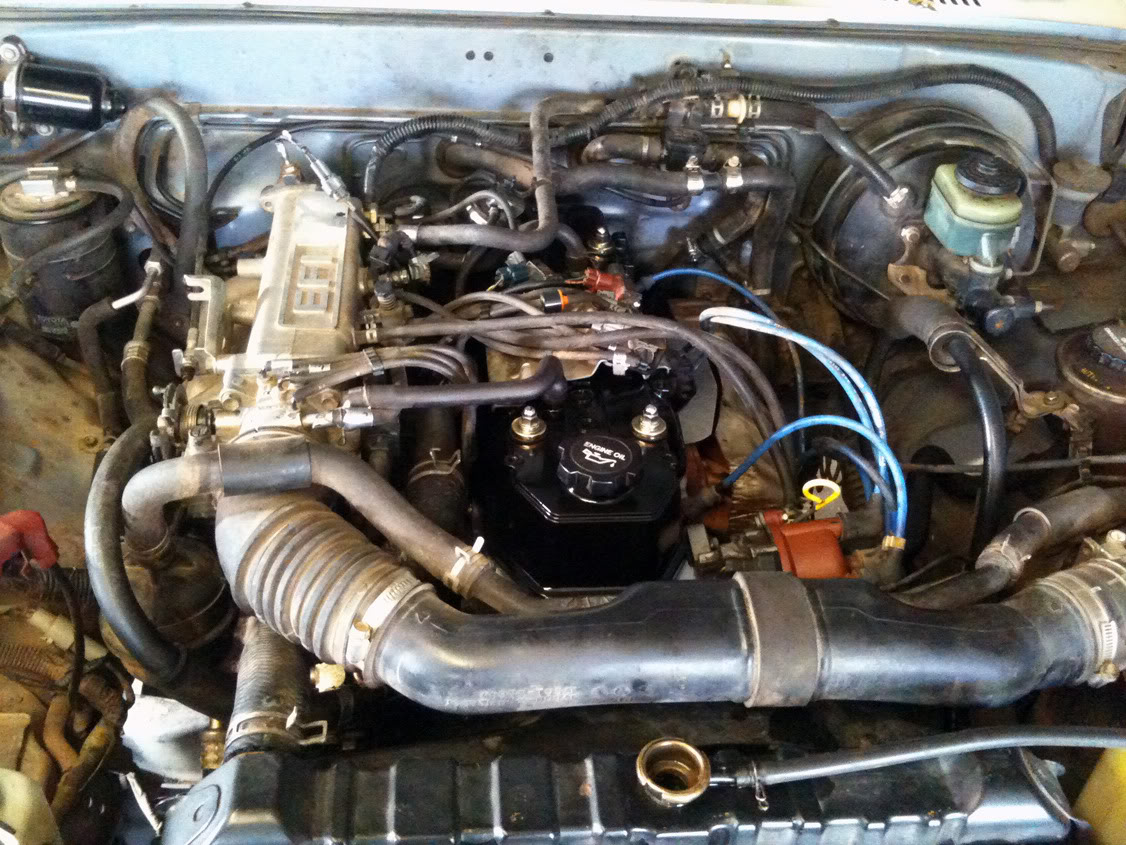

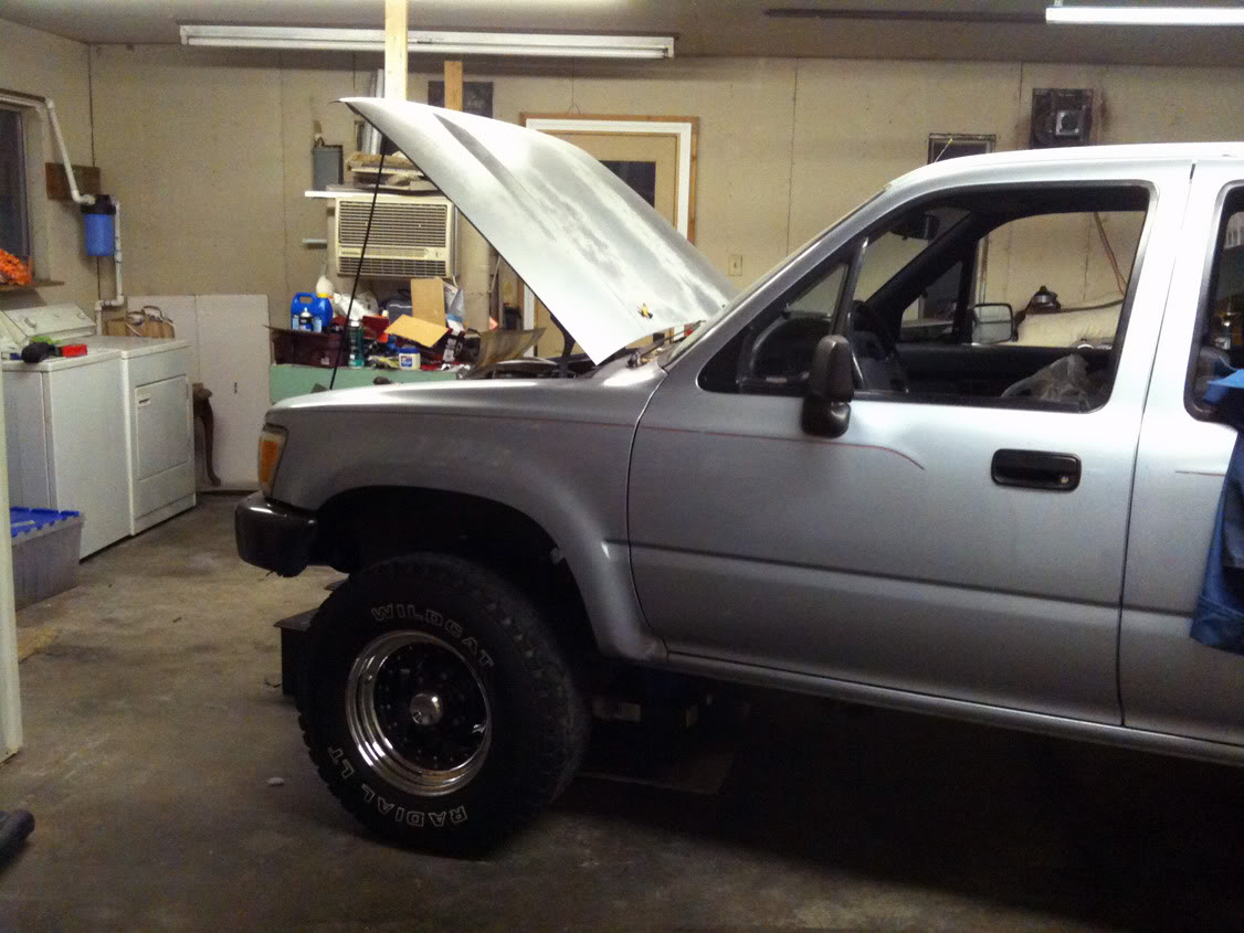

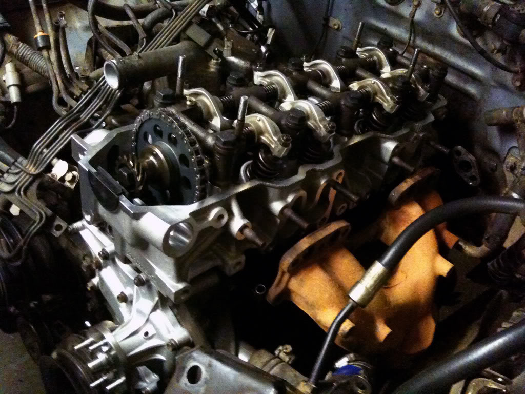

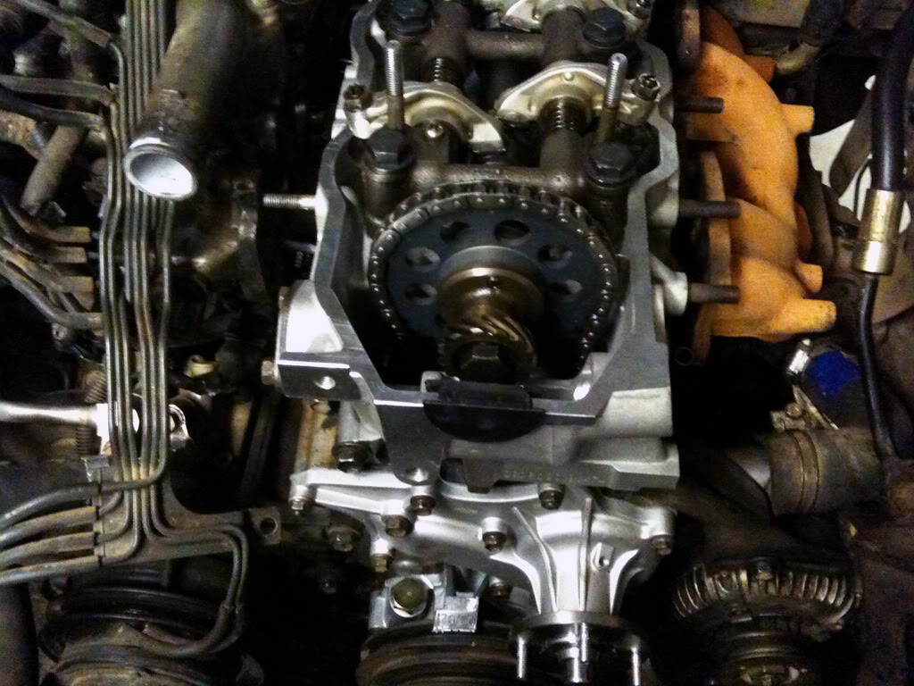

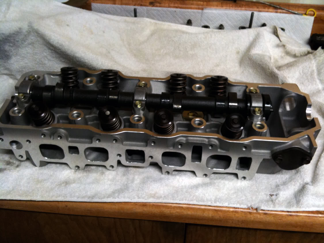

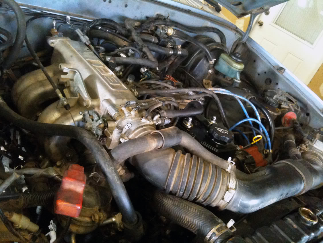

More progress! Big night tonight.. the head is on, everything is torqued to spec, including the dreaded crankshaft pulley bolt. Lot's of shiny parts on this old truck now! It's all downhill from here... I hope...

Only sleepin' in the garage for a few more nights!

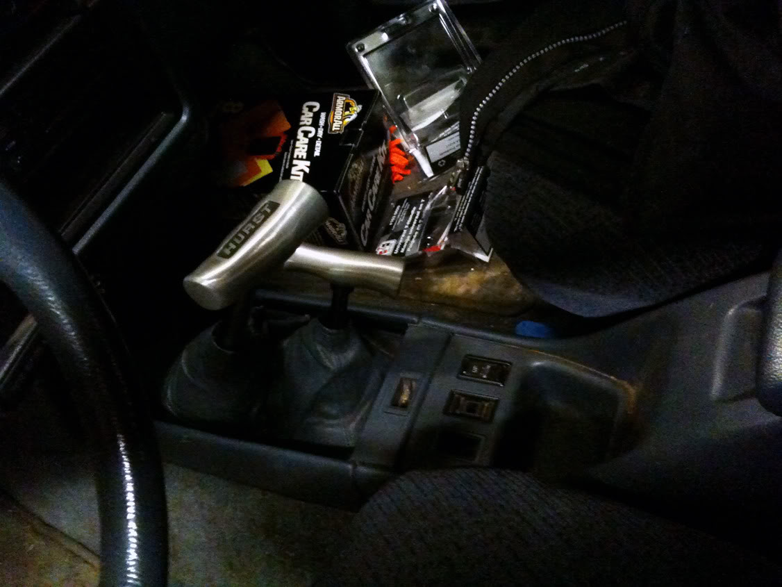

Around here, if you drive a Yota, Hurst shift handles are a must. Plus I just like them and got them for my birthday so why not....

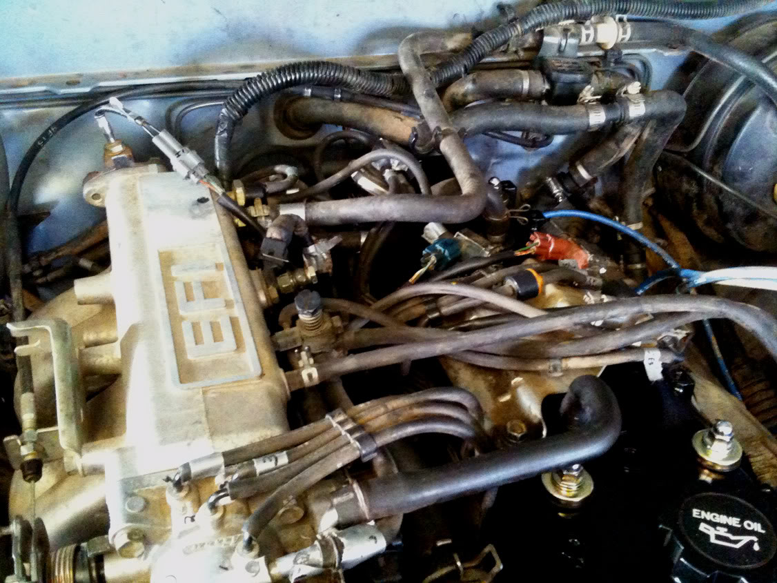

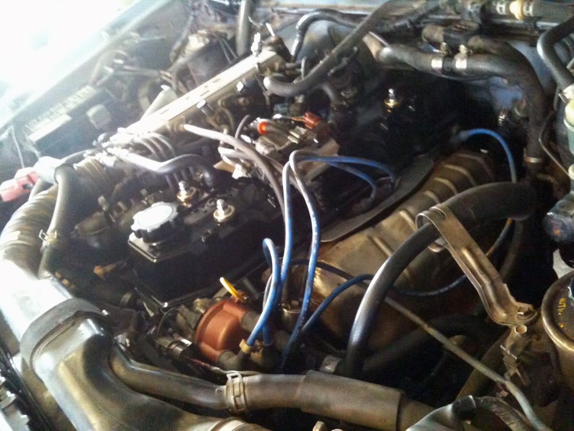

Man I just wanna get this thing running. Here's some pics. I'll get a video of it starting and failing soon.
