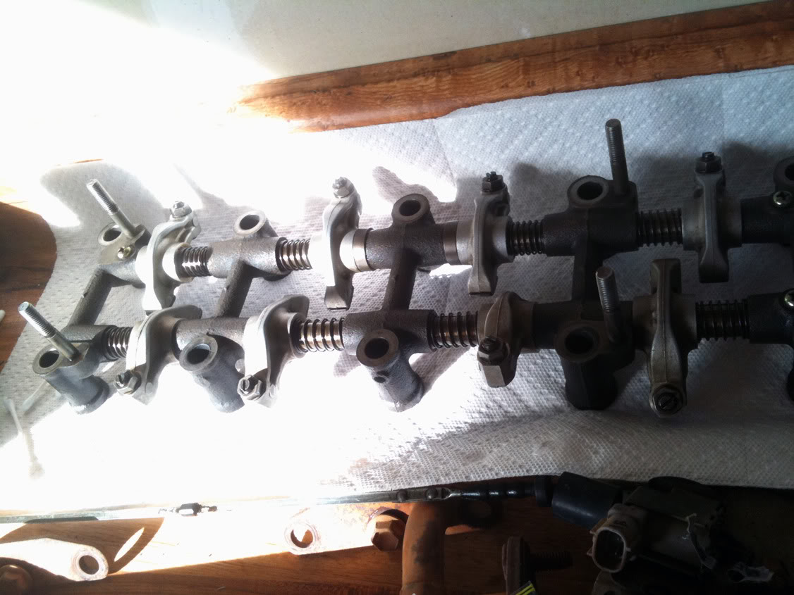

Update!
Got some work done yesterday, so I though I would post an update... Along with a few concerns / questions I have for the rest of the timing chain procedure.

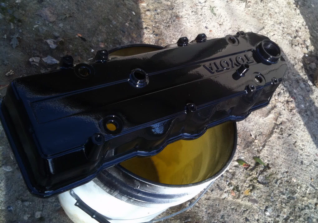

Valve Cover Painted:
Rocker Arm assembly Cleaned:

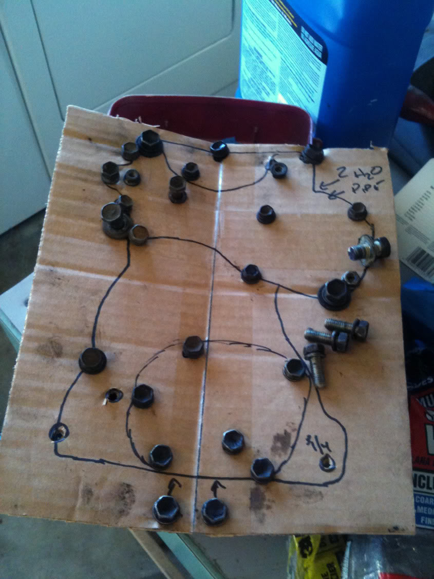

My cardboard template for the timing chain bolts. (Excellent Idea btw)

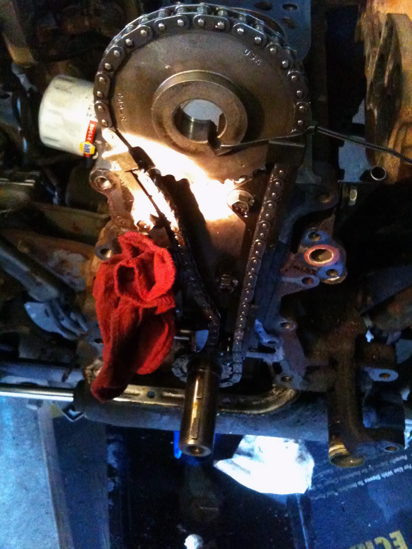

Alternator, brackets, Crank bolt, Crank bolt pulley, Water pump, Oil pump, and timing cover removed:

put some tape on top of those bolts or a rubberband on the threads just in case you drop that thing on the floor, so they don't go flying all over the place.

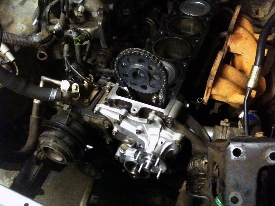

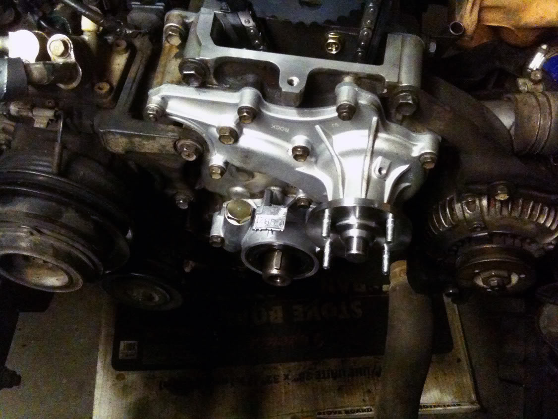

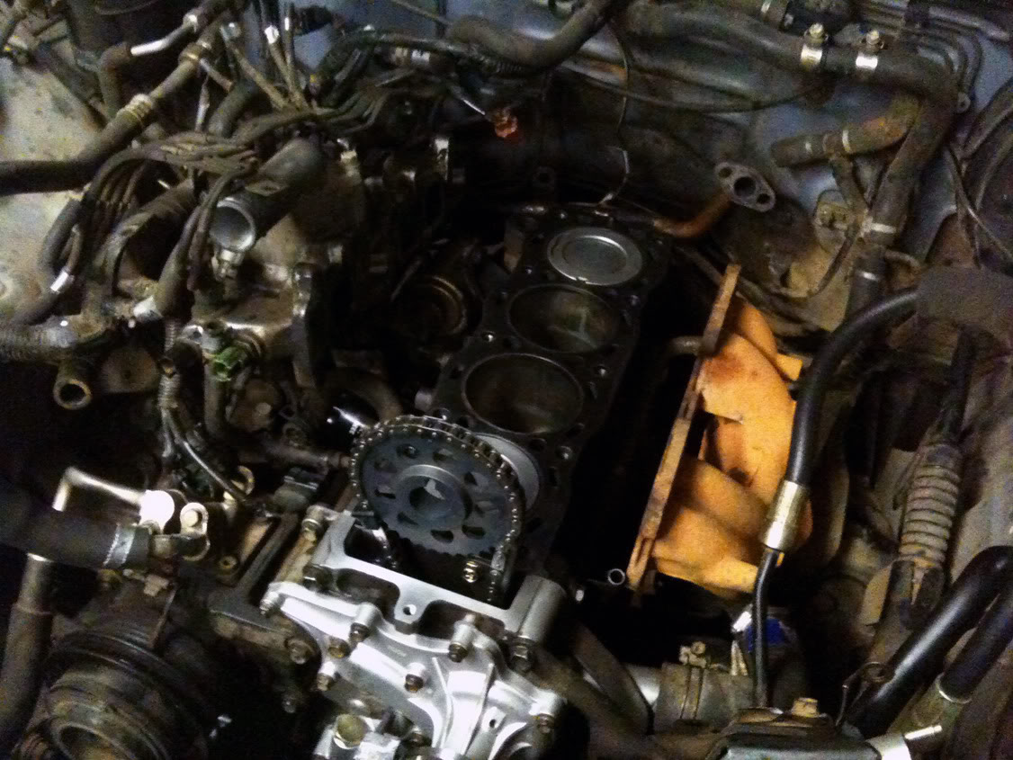

Update! Got quite a bit done tonight.
- removed Timing cover and old timing components.
- cleaned T cover, and installed new cam and crank gears, new chain, tensioner, oil pump, and water pump.
- Also reinstalled the alternator, and AC condenser, as well as changed teh oil filter while I was in there. Fuel filter will come tomorrow.
Lots of scraping, cleaning, patience, and here is my progress for tonight.
Being officially on the re-assembly stage feels great! Feel free to keep the tips and suggestions up for I'm sure I'll forget some things along the way. Thanks for all the help so far.
