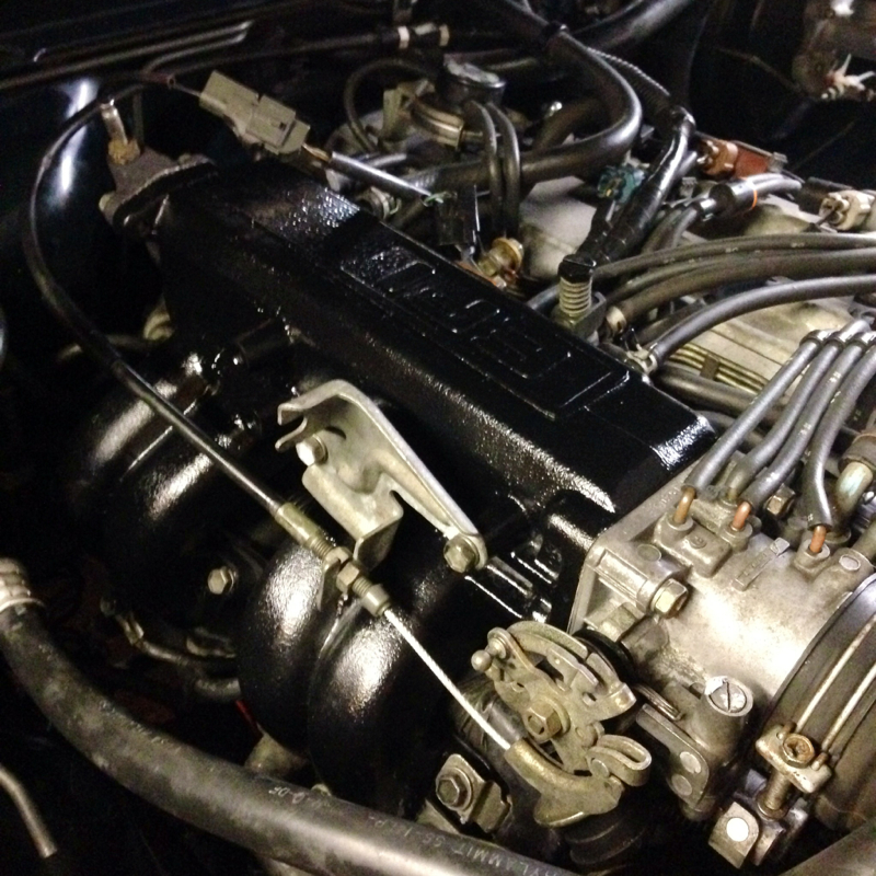

Cleaned the intake manifold, throttle body, and her valve! Fresh oil change and a bottle of gum out.. Thing runs like I picked it up from the dealer in 94!
Thanks again for the help

Cleaned the intake manifold, throttle body, and her valve! Coat of paint on the manifold, fresh oil change and a bottle of gum out.. Truck runs like I picked it up from the dealer in 94!
