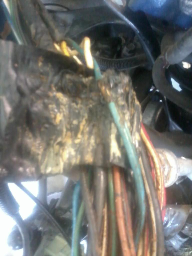

The crimps in the harness will pass a resistance check but still not let the injectors fire.
