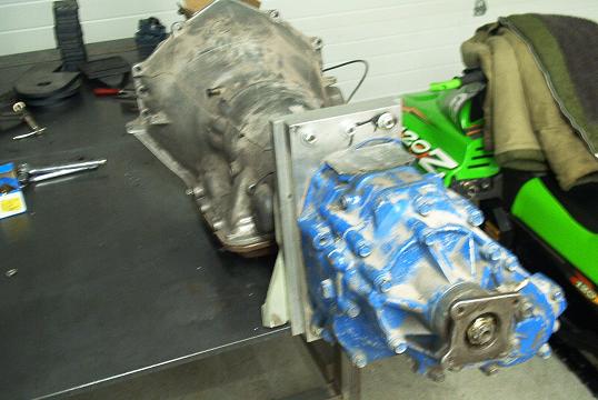

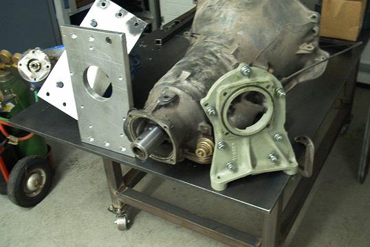

4.3 with 700R4 mated to toyota transfer case
I mated a toyota transfer case to the 700R4 4spd auto behind a 4.3 chevy. Slipped it all into a suzuki samuria with toyota diffs.
Attached Thumbnails 22re to 4.3 or 350 v8 swap-im000236a.jpg   22re to 4.3 or 350 v8 swap-im000237a.jpg   22re to 4.3 or 350 v8 swap-im000242a.jpg
