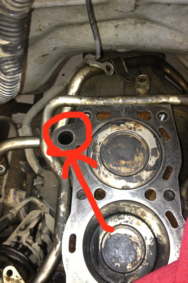

So at the back of the block on the passenger side there is a hole in the block that is supposed to be there that is one of a kind compaired to all the other water holes on the top. I accidentally dropped a piece of wood in this hole and I was wondering where this hole leads too. The hole is only visible with the head off. Thank you.

That said, I don't know the answer but would assume you want any holes on the head/block mating surface to be 100% clear of anything. Maybe try some compressed air to scare it out of there? Can you see it?

Thats the oil drain passage. Get that piece of wood out of there.

22re-img_3144.jpgHey guys i am so sorry for posting 4 threads. i have so many because i was using the yotatech app and it said it failed to post when it didnt. I am sorry not trying to spam. Here is a picture of the Hole. and toyota4x4907 thank you very much

But yeah i posted a picture a few posts up of the hole it fell into. i tried vaccuming it out with a long tube but that did not work. I could take the pan off but i dont have any more gaskets for it.

OK get a shop vac, empty it out clean. Then get the smallest nozzle on the suck end and go to town. With a spic and span clean vac you should see if the wood came out. Worked for me.

Yes sorry it took me so long to reply but i took off the oil pan and sure enought there it was
