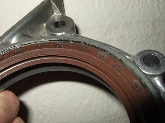

Today sucked. I cut my thumb with a misplaced hammer swing and ruined my Toyota rear seal. Great progress.
The seal was a &!@^# to get in. Hammering on a block of wood around the edges didn't work (yes, the outside of the seal was lubed), so I put a block of wood over the whole seal and wailed on it. That finally got it in about flush, though doing so created some small cracks around the extra outside lip (double lipped seal).
The seal was narrow enough to set deeper in the housing, which would put the sealing surface in far enough to be away from the groove in my crank. I don't have anything the right size to seat it deeper. So, I tried an allen head driver on the end of a socket extension. Went 'round and 'round.
That seated the seal deeper. And bent in its sides. And made gouges in the seal housing.
So, now I don't know what to do. Use a seal from Engnbldr and cross my fingers? Sleeve the crank and use a seal from Engnbldr? Pay $30 or so for another Toyota seal and pay a shop to put it all the way in the housing (assuming they don't F it up too)?
Frustrating.

Bummer about the seal. Sounds like you at least got your rings on. I finally finished fully disassembling my 22r a few days ago, get to takeing a closer look at it this weekend. I've learned alot from your thread, most of all stay away from Rock products! Keep a Hawkeye on your machinist, and inspect all parts that come in the mail. Good luck and remember, your going to need an empty box sooner than later and its always noon somewhere!

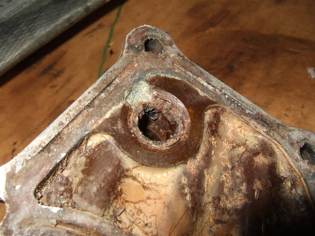

One of these days I'll get a new (to me) intake manifold. The existing one will do for now. Here's a picture of the odd eroded spot where the metal coolant pipe screws into the "water bypass plate" on the bottom of the intake manifold (shown in the last pic in post #21). The plate could be replaced.
The rest of the plate inside is actually quite good. The picture is deceiving. Ignore the gasket debris.

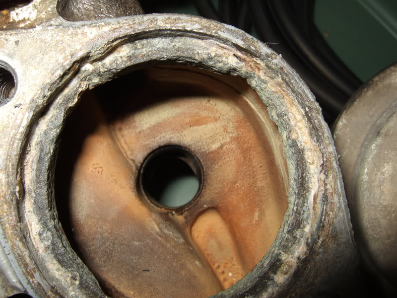

The eroded thermostat ledge can't be swapped out.
Most corrosion seems to be where coolant has been trapped between surfaces -- where hoses slip on, around the t-stat gasket, passages around the head gasket, etc.

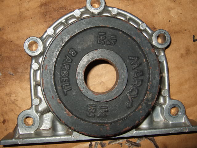

I'm kicking myself for not thinking of this earlier when hunting through everything else on hand. This plate fits in almost perfectly with a little less than 1/16" clearance around the edge. It's almost disgusting how nice it should work. The seal driver kits I've seen don't go this big.
It still may have ruined the outer "double lip" on the Toyota seal. I'm not sure. For that, I think ideally you'd want something like an appropriately sized pipe.
The seals Engnbldr supplies don't have that outer lip, but they are thicker (deeper), so would need the back side sanded down some to be able to fit in deep enough to go past my existing crank groove. How to do that evenly, and without going too far, will require some more thought. Or I could pay $35 for another Toyota seal.
The Toyota seals are thinner, but are metal lined inside. I don't see any metal in the Viton from Engnbldr. Thinning one down may compromise its rigidity.

If you have a bottle jack id put it up against the bottom of my frame or a cars and let it set that seal for you.

If you think your seal housing is toast, I have a spare. You're more than welcome to it.
Old Dec 10, 2009 | 06:21 AM
  #157
highway's Avatar
Joined: Sep 2006
Posts: 284
guess i was lazy, i didn't remove the seal housing. just pulled the seal and replaced it on the block
Old Dec 10, 2009 | 06:53 AM
  #158
broncbob's Avatar
Posts: 89
From: Salt Lake City UT
I have never done the seal in question, but a seal is a seal right? If you think you hosed your Toyota seal, then replace it. It will drive you insane and keep you up at night if you don't. You should be able to save the housing, as it just appears to be nicked around the very lip. Just lightly sand the ridges off the nicks, but don't try and sand them all the way out. You just want to make it smooth for the new seal to go in. If there is a seal number on that seal, you may be able to call around and find the same seal for less, it just won't say Toyota on it.
That plate looks like it would drive the seal nicely, The big head ache will be getting it to go in even. A press would work the best, but any thing that would press it evenly will work, Like a bottle jack.
Old Dec 10, 2009 | 07:51 AM
  #159
highway's Avatar
Joined: Sep 2006
Posts: 284
FWIW i used a fel-pro brand seal and works great

I got the seal back out and the burrs filed down. They were only on the chamfer, not the inside seal surface.
My original 1986 seal says NOK AH3730F. The new 90311-80010 double lipped Toyota seal says NOK AH3732P. A search on that doesn't turn up a useful model number.
