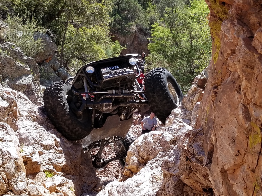

Hey guys, 10 years later we are still going strong! We did end up making a dual fuel kit as well as our straight propane kit.Thanks for the kind words. I hope you all are enjoying your Yotas as much as I do mine
The kits have only gotten better as well as cost less than a decade ago! We also have online ordering now too. www.propaneconversionparts.com is our online store.
Cary
