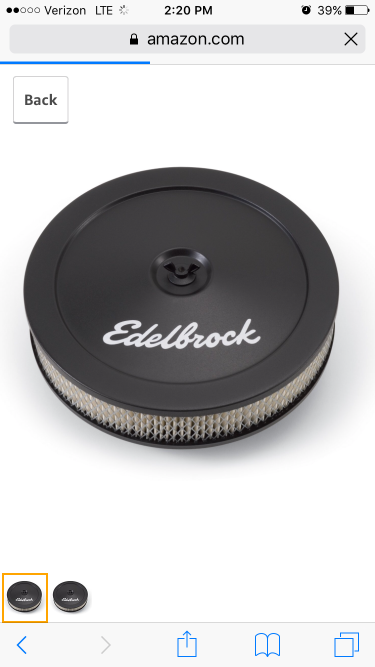

Carb filter upgrade.
Hello everyone have and 87 fully rebuilt with bigger cam. Put on a Weber 32/36. Has any one upgraded the filter to this could you tell a difference in performance

I don't think there will be a difference in performance an a 22R series engine, unless it is heavily modified. I think these are more for show when you open the hood than a performance increase.
If this takes the place of the original air cleaner setup (with intake tube behind the grill) you will be sucking warm air into the engine.
This filter looks a lot better than the standard rectangular filter you usually see when people convert to a Weber carburetor though.
No you would not notice any difference in performance. No air filter will change performance. That's just marketing nonsense. Theoretically air filters can change performance if they are less restrictive and higher flowing but it's so extremely minute that you would never ever notice it. But I'm sure that filter will clean intake air just fine!

Thanks my next question what if you when with this along with the other filter and did a forced air induction
