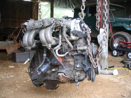

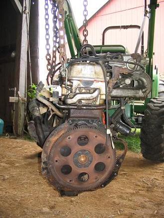

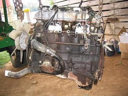

I have a few pictures of the engine. I am deferring to the experts to let me know exactly what I am dealing with. I just need to know if it will bolt up to my 87 runner and the existing EFI system without modifications? Also I would like to possibly rebuild the engine so I would need to know exactly what block and head I am dealing with. Thanks again for any help. Hopefully the pics are clear.

Yes it will. I cant tell you for sure what year exactly, or if the harness will be the same, but it will fit.
That looks like air injector near the exhaust side, I know I had it in my '88, but it stopped at '89.
So it should bolt up and it looks like your harness should work too

It looks like a 83-84 Celica 22re engine. They used the older tall deck blocks and large combustion chamber heads. Very reliable engines! Look at the block on the driver’s side just behind the motor mounts. If it’s an 85 or newer short deck block it will have the embossing for the turbo oil line. If it doesn’t, then it’s the older tall deck block. Compare this to your old 87 22re which will have this. Either way, this engine will work just fine. However you will need to use all of your 87 EFI parts.

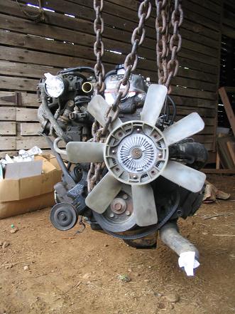

Also had one more picture, don't know if it will help or not.

You will need to know if it is a tall deck (81-84 22r/re) block or a short deck (85-95 22r/re) block. You know that the head is an 81-84 so you will need to order parts for it. I would assume and from the pictures it looks like a tall deck block. Putting a 81-84 22r/re head on a short deck block requires a lot of modifications to get the timing chain to work. Same mods that people have to do to install a 20r head on a short deck block.
Check for the protruding embossing on the drivers side of the block. If you need a reference, compare it to your 87 motor which will have it. It kinda looks like a Mickey Mouse head.
