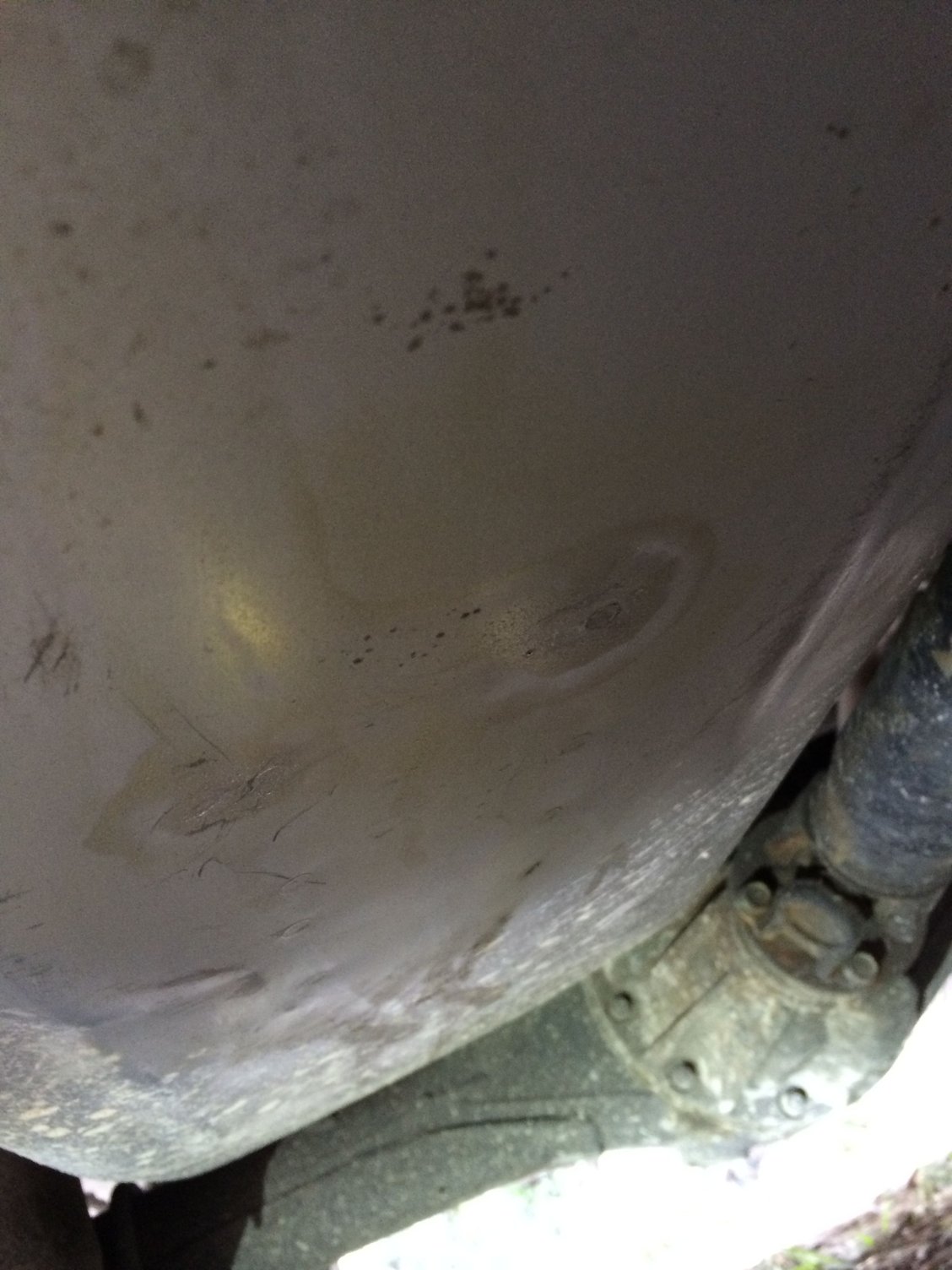

Both times it was mounted by two different highly qualified service mechanics. Maybe if I decide to get another one I should add some mounting straps across the bottom? But geez, the original one lasted 22 years! Here is a photo of the two weld leak points.
note the two circles at about 2:00 and 8:00 so to speak

That is a manufacturing defect
Poor spot welds where a baffle is welded
That has nothing to do with the mounting
If your getting another one I would inspect it real close .
Cheap China built tanks
The quality control person is most likely to get shot !!
As long as this problem is not fixed every one will start to leak in a short period of time

I'd just drop it, drain it, run exhaust from a running truck thru it for 15 minutes, or so, and braze the holes while the exhaust purge is still running.
If you wanna make sure that the internal baffle is secured, drill a 1/8 inch hole thru the factory spot weld, so that some braze may flow thru to the inside before you finally close the hole with more filler.
I have brazed dozens of tanks using engine exhaust purge, and I haven't blown one up yet.
