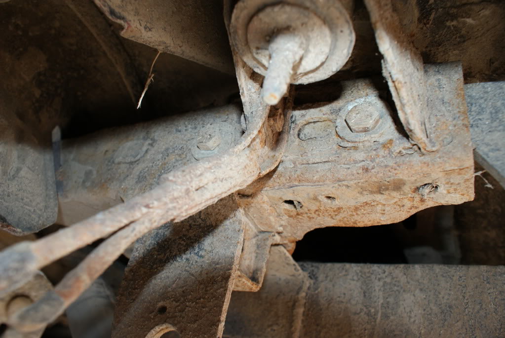

The first picture is the drivers side mounts. The holes were there, one under the body mount and the other just to the left of it in the picture.

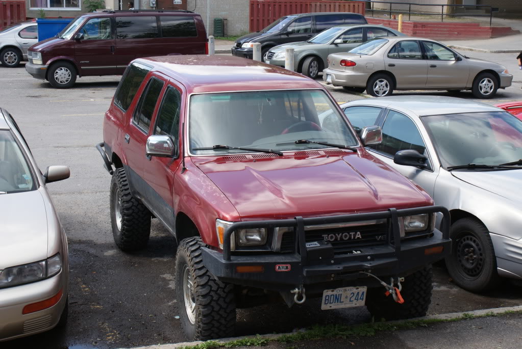

I ruined the other full photo I had trying to photoshop it, but here's a side view of my Baby.
