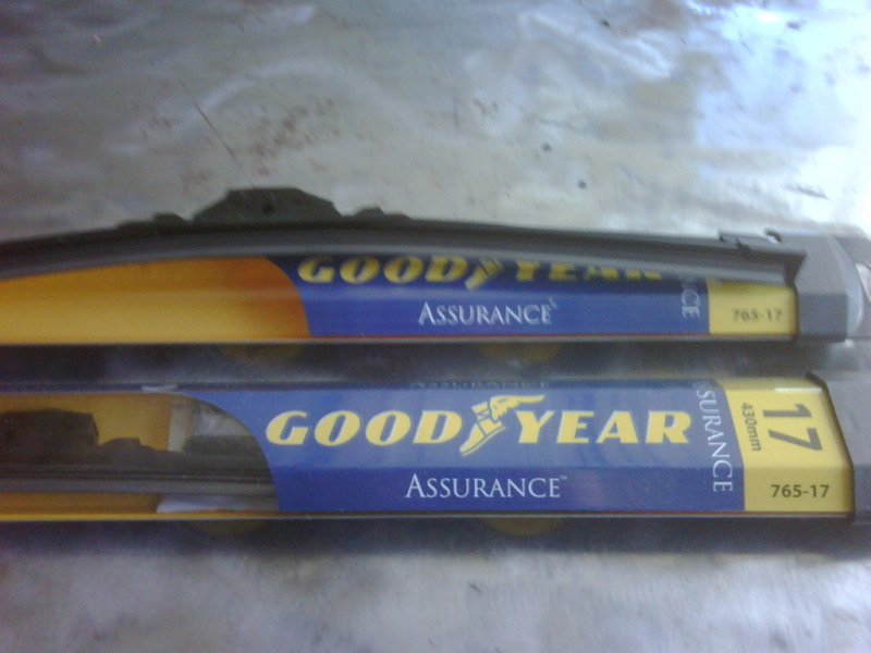

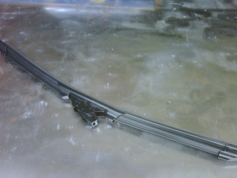

It seems like a lot of the used cars/trucks I've owned through the years, the wipers are always a problem replacing blades/inserts as most people end up buying aftermarket complete wiper blade from AP store as I guess it just seems easier.
Like I said earlier its so much easier when it's oem and you can just replace inserts.
Mine was also changed to aftermarket blade assembly.
So I buy complete blade assembly when winter time is near.
I bought this set about a month ago at Costco. I used them before with no problems, so I just stuck with them for now. A lot of plastic.
Redeth, I hope you get it figured out and working, good luck.
