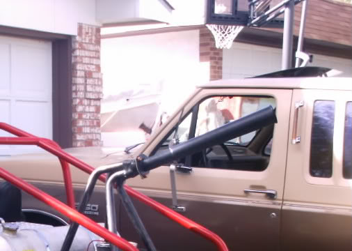

Here's a pic of my sunroof. It's all I've got for now, hope it helps.Name:  toyota016.jpg
