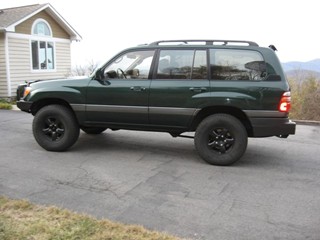

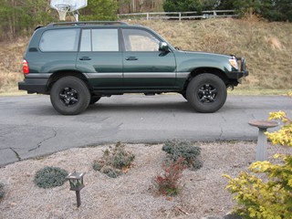

Hey guys, I've been hanging around 4 a while. I'm intrested in 84-85 runner or 1st generation SAS 2 become my wheeler and some DD. Are these things reliable or they gonna nickle and dime me 2 death. Lookin at putting 5-6 grand into it. I don't want something that will leave me stranded on the trail. Right now I wheel my 100 in sum pretty rough places and I don't wanna tear her up 2 bad. But I may just put more body armour on my 100. Oh yea how good are these things off road. 22re or 3.0..Few pix of my 100..Thx Tim
