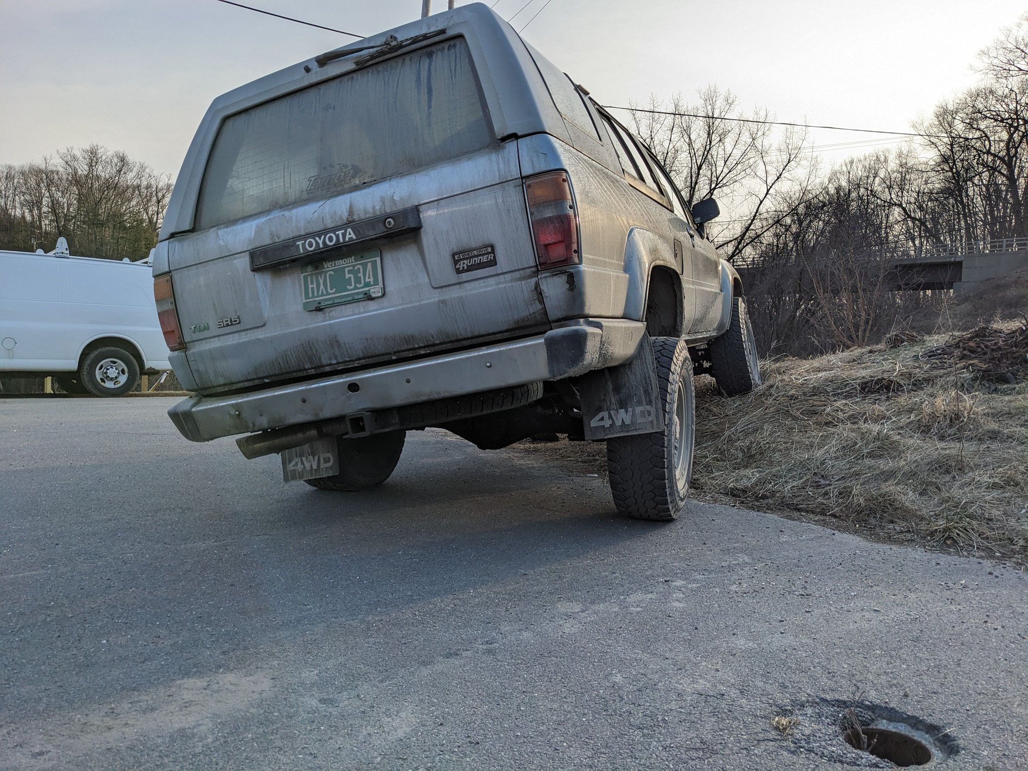

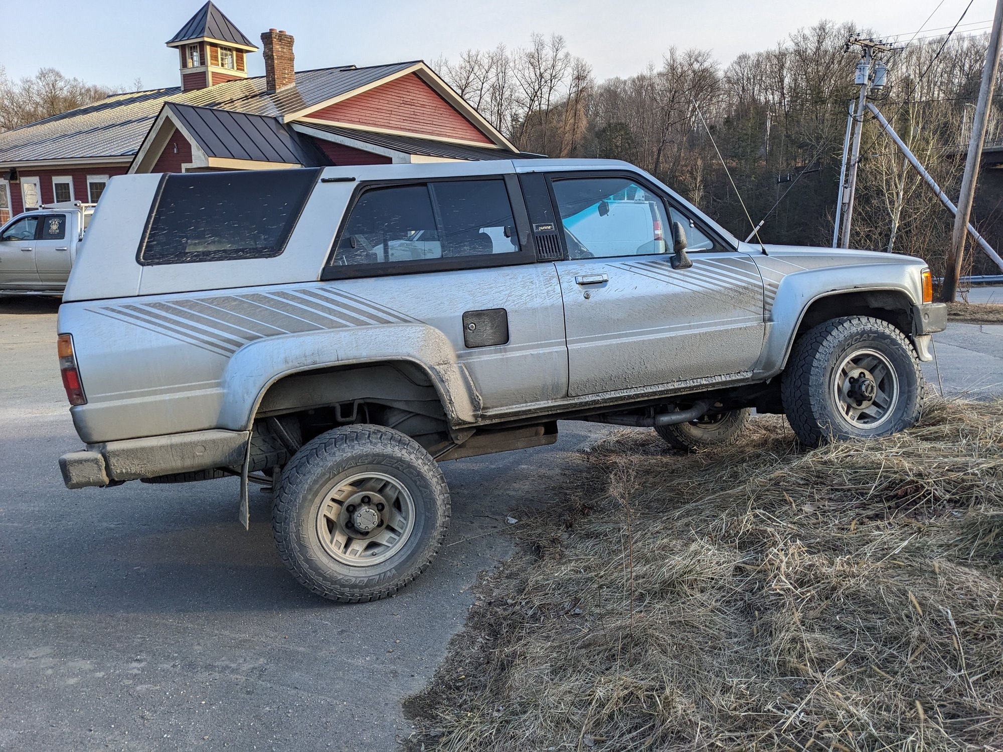

Hey yall!
After TDI swapping my 1988 4runner, I decided to lift the rear bit to match the 1.5" lift the front end received from weight reduction (150lbs roughly). I'm sure a similar front lift could be achieved by simply cranking up the torsion bars or adding ball joint spacers but that's beside the point. This rig is my 4th pickup/4runner and over the years I've experimented with bunch of different spring shock combos. For this project however I didn't want more than 2" of lift, didn't want anything too stiff and I wanted to keep the cost down.
I ended up purchasing the following for the build:
$100 Old Man Emu CS009R Springs (slightly used locally from someone who found them too stiff)
$55 Ruff Stuff Bump Stops https://www.ruffstuffspecialties.com/R1862.html
$85 Napa OE Proformer Shocks (rebranded Monroe "white" bodies)
Total: $240
As many of you probably already know the OME springs are quite heavy duty and will lift your 4runner about 3"-4" so immediately removed the 3rd leaf as well as the last (shortest) overload spring. I've run Bilstein 4600, 5100, Skyjacker and Rancho shocks on various trucks over the years and I decided to go with the OE Napa shocks for three reasons. They have the longest stroke of any shock I've researched for these trucks (13.5"-22.5" roughly, I can't remember the exact spec but you can ask Napa and they'll tell you). They were only $40 a pop and lastly they come with a lifetime warranty. The bumps stops on these trucks tend to be pretty harsh, and more often then not, non-existent. For this build I simply threaded a chunk of 1/2" scrap steel 3/8"-16 and welded it to the old u-bolt perch. The ruffstuff bump stops then thread into the chuck of 1/2" and are easily replaceable. That being said I haven't had any issues with them, they bottom out very gently and I will probably never replace them.
Since the build the truck has been daily driven hard on and off road for 4 years. The suspension settled some and I'm super happy with the height, softness and handling. I've bottomed it out a few times with no issues and the traction in the woods is phenomenal for a basically stock truck.
Attached are some recent photos of the stance on level/non-level terrain. Feel free to ask ANY questions, my goal here to provide info for anyone interested in replacing their clapped out suspension without breaking the bank!
