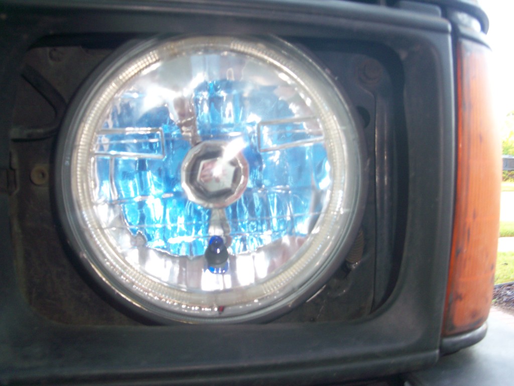

Heres a quick parts list:
Headlight buckets- pre 81 camaro---ebay
Headlight retainer rings- Same year range camaro--amazon/ebay
Headlights- 7" round h4 projector housings--ebay
thats pretty much it, most factory hardware is reused. If anyone wants close up pics, i can pull the lights out and take some pics.

More pics
I thought id post a few more pics of the lights, ill even put the vid of my marker light into turn signal mod. Let me know what you guys think.
