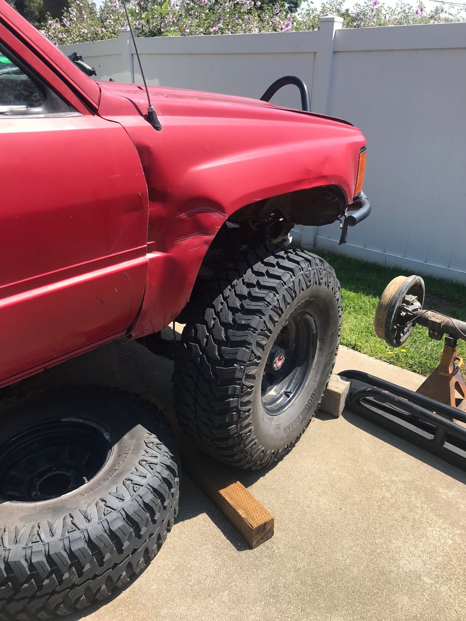

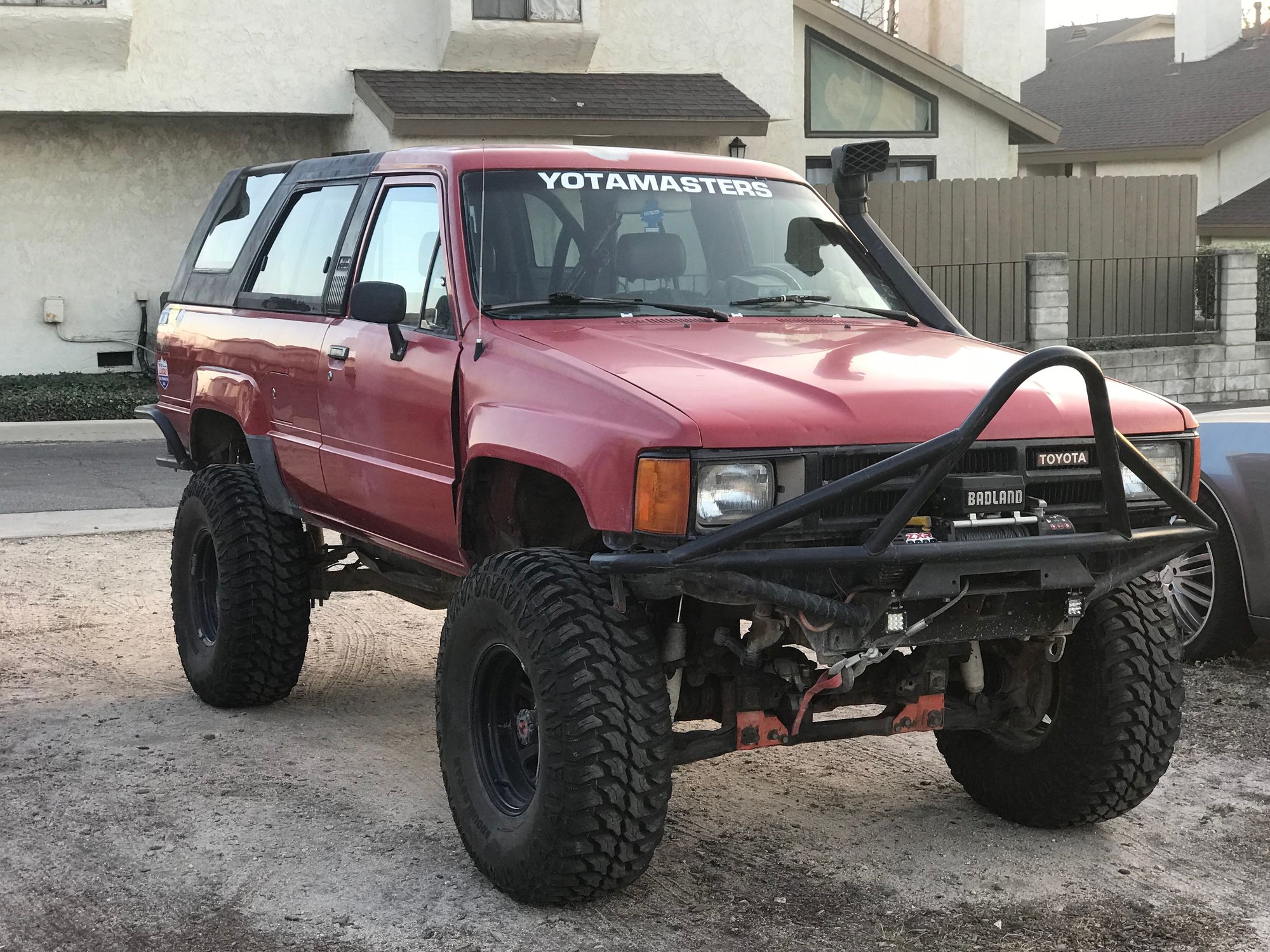

Don’t know about a 94 but it works on an 86
If you don’t use bump stops the tire smacks by the pinch weld hard doesn’t matter if you hammer it in really
