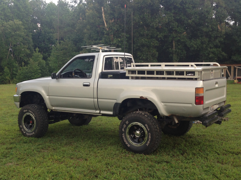

Really excited just got my truck back from the shop and it looks good to me wanted to see what some other people thought. It's a 4 inch RCX suspension with 31x10.50s

Cool. Looks like your ready for 35's

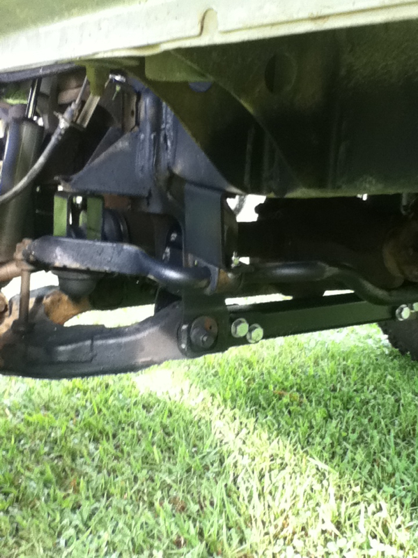

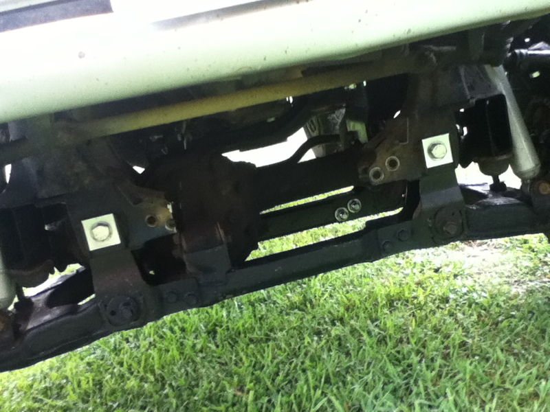

Can you take some pictures of the IFS and perhaps a closeup of how the geometry works of the IFS with a 5 inch suspension lift.. I'm curious... I've been researching to see what are my lift options.

Best I can get for now tell me if they need to be any better and I will get some after work

That will do, thanks. I wonder how much additional 'travel' does this 5 inch IFS lift provide? From what I can tell, the geometry of the IFS doesn't allow for much additional travel with any lift.

The same as stock. It's a bracket lift.

No additional travel, unless you leave off the bump stops. Bracket lifts just move the IFS down. If you want more travel, your looking for a Long Travel kit, such as Blazeland or Total Chaos

Is that a yagi sticking out of the cab?

It's for tracking deer dogs haha I make em at work it's so you don't have to get out of the truck to track em
