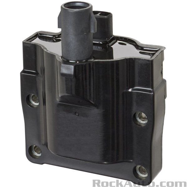

First of all its about my 1994 Toyota Pickup 22re 4wd. I've been looking at swapping my ignition coil trying to narrow down misfires at idle and code 25 lean(already changed plugs, wires, cap, rotor, injectors, FPR, fuel pump, oxygen sensor, adjusted TPS to FSM aswell as checked VAFM). Anyway the real question is regarding my ignition coil! For some reason when I changed the wires I noticed to coil to cap wire didn't fit inside my ignition coil(I ordered wires for 92-95 or wtv it was) so that got my thinking wtf! did i get the wrong ones! I went online to have a look at different wires and noticed that the ones for early models would fit! Now I looked online and figured out the ignition coil for a 1994 was waaaaaaaay different then the one I had and was actually for older models.
Soo was this swapped at some point of its life or what is going on? Could it cause issues with the ignition? Can I use the igniter from the old style with a newer model ignition coil(Probly not had they have about 100$ difference and different part numbers)? There is no trace of any shenanigans went one with the igniter or coil itself beside the pickup coil wires being soldered instead of the usual plugin.
Pictures here of the coil I currently have(Cylinder shape) and the one that SHOULD be in the truck(Box style)

Most likely it was swapped at some point. Is your current coil red? Toyota did use a round coil like the first picture on older trucks but it did say Toyota on it. As far as it affecting how the engine runs, it should not affect it unless the coil is failing. You could swap the the newer style and see if it helps. I see you have changed a lot of parts, I recommend testing each part according to the factory service manual and verifying if it is really bad. Many new aftermarket parts are no where near the quality that Toyota used back in the day.
The ignitor on the truck is the stock one or came with the round coil and the wiring modified? Based off some quick googlefoo It looks like the round coils came on trucks through 1993. What is the build date on your truck?
Take a picture of this solderd wiring as well.

The coil is red in fact! I just looked up the year it was build in and as per information acquire and my vin (10th digit being P). It was built in 1993! Well that solves that! Thanks!
The only other issue now is I'm running a distributor cap/rotor and wire from a 1994(they have lock clips) hopefully they are the same in terms of specs?
